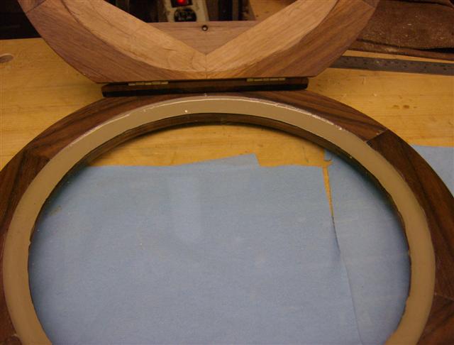

Jack Guzman from Maine
What I did
>Thanks Paul and David for your responses. I got impatient.This is the final step on a clock I've been working on for quite a while.I'm building a regulator clock like a type 2 Seth Thomas.Instead of a brass bezel I decided to use brass pins and glazing compound to hold the glass in the door.
I put about a tablespoon of mixed minwax dark walnut into a fistful of compound.I like the result.It came out more gray than brown however.Next time I'll try artists paint or pigments.
Here's a picture of the inside of the door.The stain thinned the compound so I have to wait for it to set up for awhile lying flat.I don't want it to puddle.(I hope it hardens a bit)---Jack
