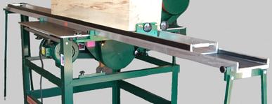

Falberg saw Co
>I made this transport out of laminated aluminum but it might work as well with formica-laminated plywood. It's basically a channel in a sleeve with the three-point clamp wedged between the inner surfaces of the inner rail. This same idea could be manifested with an improvised angle instead of the channel I used for squaring logs. As crude as it was (and labor intensive) it is an *extremely* accurate approach. I still use it and no, it's not for sale at any price. If I had to do it again, I would have used formica-on-plywood. It's 12' long and will accomodate an 8' log or beam.

Falberg saw Co
>This is a detail of the clamp system. Two sharpened 3/8" threaded rods on a knob oppose a single, similar screw at the other end allow you to position your cut precisely and holds it at whatever attitude you choose. Again, this could be done with plywood, but aluminum turned out to be easier in this instance.

Denis Ch�nard, Orl�ans, Ont.
>Pretty neat, similar in principle to what I made, but more sophisticated than my setup.
Thanks for the pic,
DC
