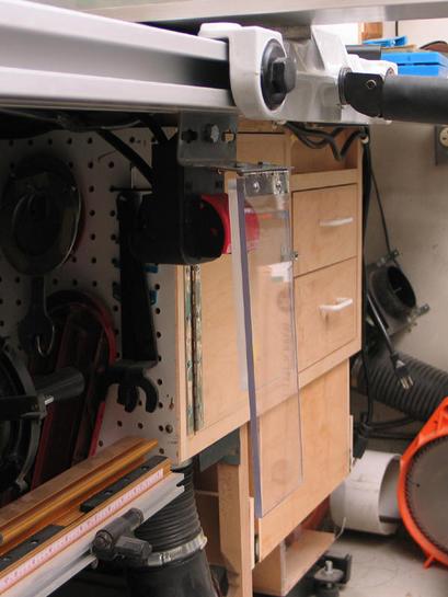

>I use the Delta switch for my router table. I added an acrylic paddle to make it a knee switch.
-- Hoa
