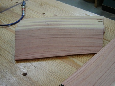

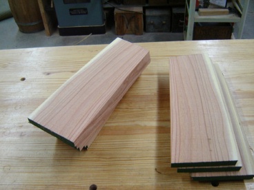

>There has been several posts lately about resawing. Thought I would post my latest episode with a piece (chunk) of Chinaberry.
First, about the Chinaberry; It is an old timey yard/shade tree here in the deep south. Not so much now as in the past. It is not a very big tree, most are multiple trunks. You can still find them out in the country. It is quite messy with a foul smelling fruit. The limbs are quite brittle. It is related to the Mahogany tree. I came across a pretty big one a few years back; about 24" diameter with a trunk of about 10 feet. I cut it down had it sawed with a band mill and stickered it. I got 21 boards 14" x 1" X 9 feet out of it plus a couple chunks, one of which this post is about. This chunk is about 9" x 18" x 8".

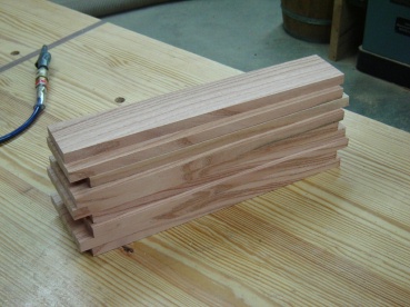

Ray Binnicker
>Here is the finished stack of boards fresh off the bandsaw.

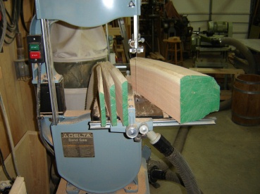

Ray Binnicker
>Another shot of the boards fresh off the saw. Oh, it is a 14" Delta with riser kit and a 1/2" Timberwolf blade 3 TPI.

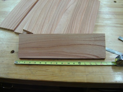

Ray Binnicker
>And another fresh off the saw.

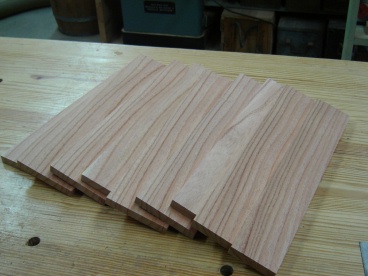

Ray Binnicker
>Here they are after jointing one edge and one face, a couple passes through the planner and the ends trimmed.

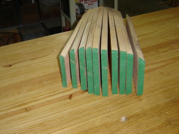

Ray Binnicker
>And another

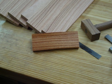

Ray Binnicker
>And one showing a small piece with a little Danish oil.
I resawed at a little over 7/8" and wound up with boards about 3/4".
The fence you see in the first picture is all I ever use to resaw. I must be very lucky, I have never had to adjust for drift. It took one pass over the jointer and one pass thru the planner on both sides.
