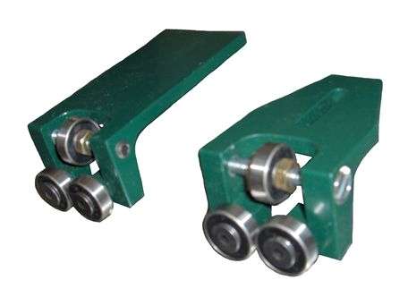

Falberg saw Co
>You can also DIY with 2" x 8" aluminum channel, a drill, 1/4" tap, Jig Saw, and file; for pennies. For example: PIC
