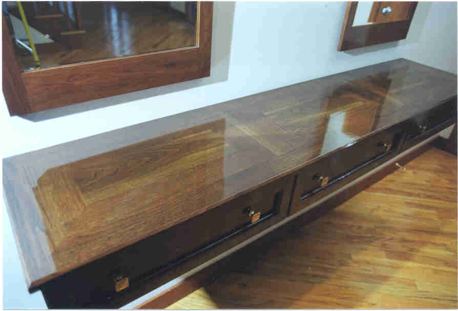

Mark Mandell - Gone Round In Jersey
>Mike,
I have done what you propose with 2 differences.
1. "Veneer" cut and planed to 3/16". [minor]
2. Substrate used was 3/4" MDF [major]
The MDF was more uniform and stable than a plywood core would be, and I didn't have to make an application to both sides to prevent warp. Plus, the top need not "float" and could be used as part of the structure of the suspended counter. The piece is now 7 years old with no sign of excess movement. The wood is walnut and the finish is oil poly.

For Contrast
>Pic is of a side bin-table in cherry and walnut. Here the bin was done is solid panels, but the top was a composit of thin 3/8" stock glued to a ply core. In this one we get some opening of the joints at the centerpoint. Underside was done in thin vaneer to match; see second pic.

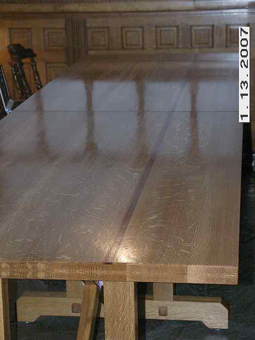

Karl Kulp
>I just finished a 1/4 sawn white oak table and my stock measured about 13/16 rough. After gluing up the full width plus about 2 1/2 inches extra in width and length, I ripped off the edges and ends and rolled them under to make bookmatched edges about 1 3/4 thick. This makes a hefty looking top that is much lighter than a full thickness would be and it should not have as much problem with splitting. I've linked to a picture, and there are other pictures in the folder of the edges close-up and of the frame, etc.
