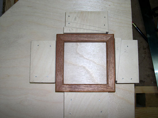

Getting the 45 degree miter is the easy part (at least for me). Use a table saw sled or shooting board as suggested. For me, the hard part is the glue-up. In my clumsy hands, the boards seem to have a mind of their own and want to slide every which way. And I am loath (unlike Norm) to use a brad nailer to help out. Using an internal spline is one way to reinforce the miter joint and help with the glue-up. For spline-less miters I make a temporary jig with tapered sides to hold the box sides in place until I can bring clamps, belts, whatever to bear on the problem. Here is a pic of a recent jig for a small frame. I've done the same for a small jewelry box but don't have any pics of that. One word of caution. Take extra care when getting ready to glue-up the sides to make sure the grain is running correctly - DAMHIKT 8-). Good luck.
Jim
