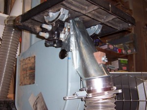

>Delta sells a port for the bandsaw for about $32. Ittura Designs also carries it I think. I got a picture of it and made one out of an "End Boot" from four inch ducting for it. The boot cost about $4. I'll post a piture if I can.
Jim, I tried cutting a hole through the door on my saw and it worked well enough except that when I wanted to change the blade, the duct acted like a spring and kept closing the door.
The pickup I have on it now comes loose with a wing nut and lays on the floor while I cahnge the blade. I think the over the table pickup would be a good idea too.

Thanks, Barry--how does it attach?
Joanne in Pt. Pleasant, PA
>Is that block of wood with the wing nut bolted to the machine and the boot just hangs on that? It the boot attached up under the table, too? I like Ed's idea of using magnets to attach, so it's easily removable for cleaning or blade changes.
I know I've seen a picture of the hose on top of the table somewhere. Perhaps here and whoever did it will chime in for Jim (Hmmm, "Chime in for Jim"--kind of sounds like the title of either a kids' book or an Irish pub tune. lol.). I'm picturing something that is adjustable, so you can move it depending on what you're cutting.
Re: DC Set Up Help for My Band Saw
Re: Thanks, Barry--how does it attach?
Barry Irby
>I took the little plastic Port that could be attached to a shop vac off. It was on a bolt that let it pivot down to change the blade. I put the bolt back and use an Eye bolt through my home made port. The Eye is big enough to just slip over the head of the bolt. I'm sure a hook would work as well or better.
I have those spring loaded Long Ranger blast gates with the micro switches. They are a little stiff to open and tend to slam shut. not sure the magnets would hold the port on, but they might and if you put the gate elswhere they probably would. I went to some trouble to put the gates near the switches fo the machines, becasue the gate turns the DC on and I wnated it to "natural" to open the gate and turn on the machine.
The port I made is "Pointed" enough at the top that it comes right up under the table insert and still allows the tabe to tilt. Not all the way to 45 degrees, but close. Maybe 40 degrees. I almost never tlitthe table that far, but on those rare occasions I just take the port of and lay it on the floor, and do with out DC for that operation. If it bothered me I think I could trim thetop of the point dow a little and allow the table to tilt to 45, but I think that might reduce its effectiveness a little and its not worth it.

That is an obvious consideration which I should have anticipated. To the plastic DC port, I installed a metal flex elbow which occupies space only under the table. A black 4" plastic flex DC drop line couples to that metal elbow. I can stand touching the table and not interfere with/ be interfered by the elbow. Why--I can stand close to the table and not have to sharpen my elbows--so to speak! :<) One other consideration: No problem opening the lower door after all the fittings are installed.
