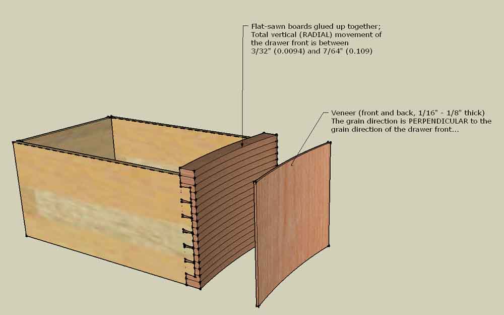

>Good morning,
I know I've posted this in the past as some of you may recall, but since I did not find the workable solution, I'll ask for your help again.
In my earlier posts I've mentioned that I am working on a desk that has drawers with a concave faces. This would be an easy task if the drawers had horizontal grain orientation, but in my case the grain runs vertical. Since I cut my own veneer, I would not have a problem cutting it up to 1/8" thick... Some don't even call it a veneer :)
Veneering a flat-sawn board (on both sides) with grain of the veneer oriented 90 deg. to the grain of the board would not work: calculated (tangential) seasonal wood movement for 11" wide flat-sawn cherry is about 0.2". Can veneer (between 1/16" & 1/8" thin) be applied this way without cracking?
Solution 1 - implemented:
In order address the wood movements mentioned above, I made drawer faces out of 1/8" thin cherry layers (layers were oriented 90 deg. to each other) and then veneered them. The problem with this approach - I have to cover the perimeter of the drawer face in order to hide the plywood look. Doing this, would completely hide the dovetails which I'd rather keep visible.
Solution 2 - will this work?
1. Glue up flat-sawn boards as show on the picture below
2. Cut concave and convex profiles on band saw
3. Veneer front and back with 1/8" (or a little less) veneer...
This approach would solve my "edge" problem described in solution #1... However, the calculated seasonal movement for this approach is (radial in this case) about 0.107" - will this cause any cracking?
Again, I sincerely appreciate all your comments!!!
Felix

>So gluing up flatsawn strips has less movement a solid flatasawn slab? I did not know that. From an asthetic perpective, the edge strips might not look a lot better than the plywood look unless the boards are all extremely close in color.

>1/8" is quite thick. In my experience wood veneer particularily where curves are involved does best when the veneer is a bit less than 1/16" or so. In your case where the grain is running vertical could you possibly do a baked in edge band to achieve the end grain look and be able to do your dovetails? The core could be cross laminated plys and then you could face the edge bands and the core with your vertical grain veneers.

>... is to make curved plywood drawer blanks out of utility veneers such as poplar, with the plies at 90° angles to each other. You'll need to make male and female forms and press the veneers into them to get the curve you want. If you're vacuum-bagging it, you only need the male form. If these drawers are stacked vertically in the piece, you can make a single curved blank and then cut it up into drawer-sized pieces.
Next, I'd glue solid cherry edgebanding all around the blanks, trim it flush and then veneer the faces. I wouldn't worry about movement or cracking if the veneers are 1/10" or less in thickness; Krenov's students do it all the time. You might want to experiment with the thickness, but I don't forsee any trouble pressing it into the shallow curves you've drawn for us.
My 2¢,

>Hi Doug,
No. I am using flat-sawn boards glued-up face-to-face. Since the linear dimension (the WIDTH of the boards) is the same, the movement does not change.
In other words, instead of having a peice of flat-sawn cherry 13"L x 11"H x 2"W, I use 11 of 1" thick flat-sawn boards 13"L x 2"W glued-up face-to-face in order to build up the desired height (11").
There is still the same tangential movement, but since the width of the "slab" is small (the width of the drawer front...), I don't have to worry about it. Due to the heght of the "build-up", I am dealing with the radial movement of the "slab".
Does this make sence?

Didn't you like solution #2?
Felix B.
>I looked at some antiques last weekend - that's where I got this idea of stocking up boards to get the desired height. But the drawers I saw were not very toll...
No one commented on idea #2 in my original post because:
a). I answered my own question by providing the calculated movement, making this not a good solution for the given task;
b). No one reads long posts like this to the very end
Felix

>Hey Ellis,
Glad to hear your "voice" :)
Since the drawers are made exactly the way you suggested (pressed in mold, used lots of clamps :) I can try the edgebonding idea - the only possible solution in the current situation.
In case I mess up, I am mentally ready to redo the drawers anyway. And if it comes to remaking the drawers - I am getting a vacuum press setup :)
Thanks again,
Felix

>as someone already mentioned the dovetails will look a might peculiar when the face of the drawer that the grain running at 90 degress to the expected. in fact, i would not want them to detract from all the work of the drawer front. one method used in this situation is the sliding dovetail, or the pinned mortise and tenon. both are suitable for mounting a drawer front to the sides, and if it helps i am not the only one who does this, pretty much all of the industry and james krenov does too.

>Your solution #2 seemed like a lot of work without a payoff. If you want to bandsaw your drawer fronts, why not just start with 8/4 lumber? I suspect that you want the quartered faces out to minimize shrinkage. But the expected difference isn't enough to matter; you're going to have a problem with the veneer overhanging the substrate if you use solid wood. Plywood is the way to go for accuracy and wood movement insurance. Stacked wood is less likely to cup than a solid piece, but neither is immune to cupping. Once you veneer it, it would be more stable becuse of the strength and moisture resistance of the gluelines.
I don't imagine the shrinkage of your stacked substrate wouldn't cause the veneer to crack any more than plywood would.
And, regardless, the dovetails will still look out of place in the context of the vertical grain face veneers. IMO at least.

>This is all clear to me know - the "plywood" base is the way to go in this case.
Also, initially I planned to have dovetails visible, but after reading the responses, I agreed with them being "out of place" in this case...
I did consider sliding dovetail as a joint between the sides and the face, but due to the drawer width, I can't do that - files won't fit. So, I am going to go with the dovetails as originally planned, but edgebond them as suggested in the earlier posts
Again, thank you everyone for helpful thoughts!
Felix.
