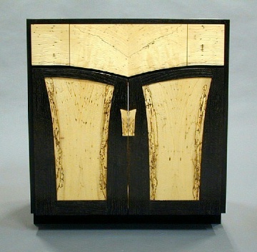

>Does any one else have a resaw/bookmatch addiction? This is a bathroom vanity I was commissioned to make. The client let me make whatever I wanted. The front of the cabinet was designed around the figure of the wood. Burnt pecan filled with tile grout and spalted palo blanco. The counter top will be tile with a black ceramic sink.
The palo blanco door panels were sawn to a little over 1/8" thick, surfaced smooth in a Dewalt planer, and glued to 1/4 plywood.
The palo blanco drawer front was resawn a little over 3/4" thick and bookmatched end to end with floating tenons. There is a shallow center drawer and two full depth side drawers. The only stipulation the client had was to squeeze every bit of storage space out of the cabinet.
I'm currently using a 1/2" wide blade 4TPI and a single point fence as a guide on a Laguna 14SE. This type of fence works better for me at dealing with drift than the fence that came with the saw.
Share your resawing/bookmatching wisdom with us, and maybe we can be enablers to those who haven't tried it yet.

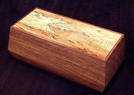

Here's my latest
A.J. Hamler
>I made this for my niece for Christmas. The lid is spalted maple, the main box is walnut.
I loooove resawing.

>Looks great, AJ. The big patterns of spalted wood and heartwood/sapwwod contrasts make very dramatic resawn images.

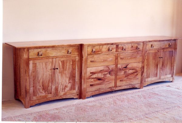

See what happens if you don't fight it...
John in New Mexico
>This is one of the first pieces I built at a shop I worked for a few years ago. Even some of the rails are bookmatched.
John

>sycamore - i know the feeling.

I can't quite figure out the center drawer though - is the whole bookmatch the drawer front and the bottom just goes straight across leaving the V shaped drop in the center of the drawer with nothing behind it? Got any drawer handles?
How'd you burn the pecan?
Beautiful!

Clay Foster
>Thanks, Tom
The rail between the drawers and the doors is about 2 1/2" wide. The v drop comes down over the rail 2" in the center. The door tops come up over the rail about 2" on the sides.
I burn the pecan with an acetylene torch. A propnae torch will work fine, it's just a lot slower. In this case, I singe the wood until it's just black, clean off the soot with a soft brass bristle brush, sand it a little with 220, and fill the pores with white tile grout. Finish is poly.
Sometimes I draw designs on the wood with mud in a squeeze bottle as a resist, burn the exposed wood until the mud turns loose, then brush and sand. The resulting pattern in unburnt wood stands about 1/16" proud of the burnt wood. I usually finish this with brown shoe polish to bring out the rich brown color of the burnt wood.
