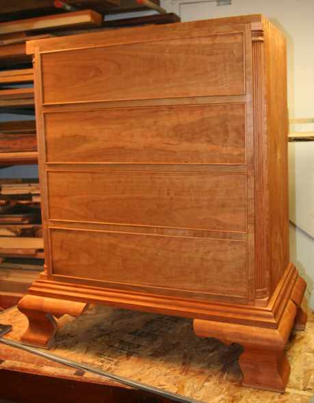

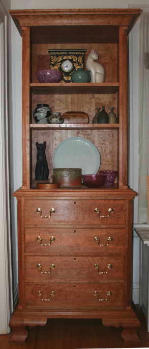

>This piece began life as various components for an armoire that never got finished. The details were heavily influenced by the Chippendale style chest on chest featured as a frontispiece in Sack�s �Fine Points of Furniture.� I made the feet, base molding, panels and sides and cornice molding, only to set them all aside from a dislike of the proportions of the armoire design. Other projects took precedence (including starting the urban logging operation) until LOML announced that they could be parts to a living room cabinet for storing the bulging CD collection with a shelf for a similarly growing horde of art objects. Great idea.
The whole thing is made of some bargain cherry I had found that turned out to be curly enough to encourage me to buy a really curly piece for the drawer fronts. (This was back in the old days when I actually bought domestic hardwoods). The drawer runners are persimmon and drawer sides are spalted ambrosia maple, both Lumber Logs� urban finds. The base cabinet has 4 undivided drawers for CDs, solid sides and frame and panel back. Using somewhat curly cherry panels for the back seemed kind of weird, but they had too many spider webs on them to not use.
This has clearly been my most ambitious project, including many firsts such as putting a motor on my 1940�s era Delta lathe so I could learn to turn the beaded columns. I am glad to have made it and I am glad it is done. I think I�ll try some small boxes next.

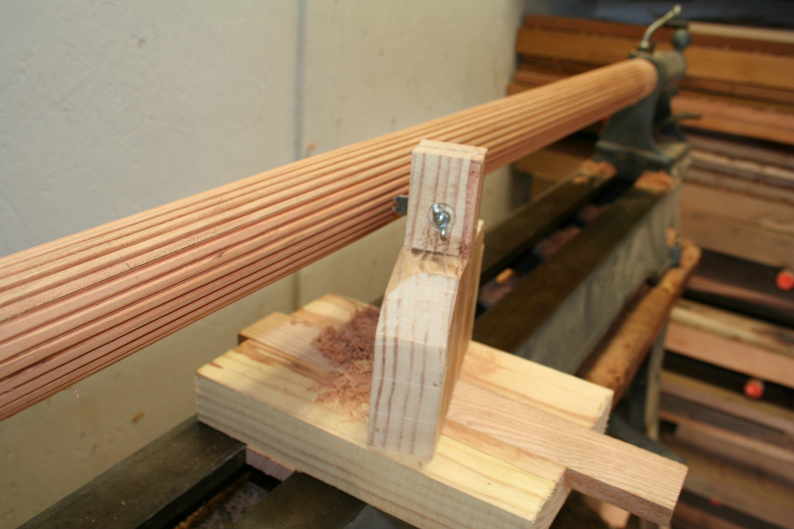

making the beaded column
Tom Sontag - St. Louis
>Thanks to Hand Tool forum members for tips on converting an old plane iron with a hacksaw and 3/16" chainsaw file into this manual beader. It worked and it was work.

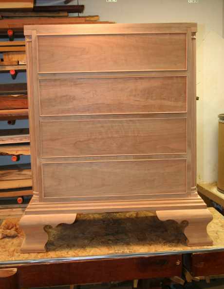

base cabinet before finish
>This shows some details a bit better.

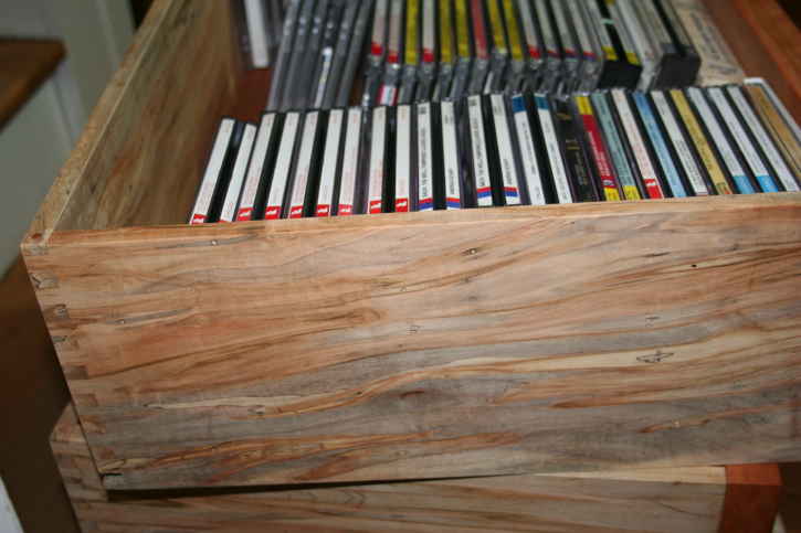

>LOML was not crazy about introducing a new wood to our decor, but some amazing spalted ambrosia maple could be used as a secondary wood. So I made the drawers with my finest finger joints ever and proceeded to cover the front ones completely with the cock beading. :-(
But here is the back of one drawer showing the cherry-pinned finger joint and some pretty cool wood.

Robert R Clough - Thorncraft
>Kinda my style of furniture. Excellent. (And since cats are good people, I approve of your statuary.)

Felix B
>Terrific job, Tom!
Who cares how long it takes - the important thing is that it's done!
This is one of my most favorite styles. It's an extra bonus when you can make it fit the today's life style.
Anyway, be very proud, beautiful work!
Felix

Very very nice, but...
Joe in a Cleveland suburb
>I just have a couple questions.
Does using spalted maple for the drawers cause strength issues? Is spalted maple somehow not as strong as non-spalted maple? I don't know, just wondering.
Also, do you by chance have any pictures of the joinery details for the front corners? I just wondered how you tied it all together on the front of the cabinet as far as the the case work goes and the columns.
It really looks nice. Great work.
Joe
Re: Chippendale style thingy I made
That's a beauty!
>Tom,
Nice job adapting the design for that piece. You tackled some tough elements there and did a great job. Your beading work was a challenge well done. Overall a great piece and well done!!
Tom
>Typically spalted wood loses strength pretty quickly, but this stuff had only just started to turn various colors; there was nothing even close to punky or weakened. It should be as strong as any silver maple wood. It is somehting to be aware of though; good question.
The front corners are simple. The solid side ends 1 1/4" from the front. 1 1/4" in from the side is a 3/4" x 1 1/4" post, screwed from top and bottom, that serves as the sides of the drawer cavities. The beaded column is simply glued to the front edge of the side and the side edge of the post and covers the gap between them.
