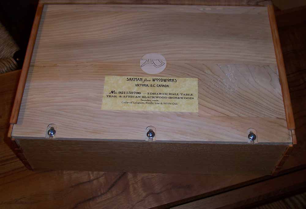

Re: How do I put a makers mark or signature on wood?
Not a signature per say.....
SanMan
>......but gluing in a penny, nickle, or even a quarter of the year the piece was done is a nice addition to the bottom of any piece I think.
That way when its passed down to your great grandkids, theres no doubt it was made waaaay back in '07.
SM
