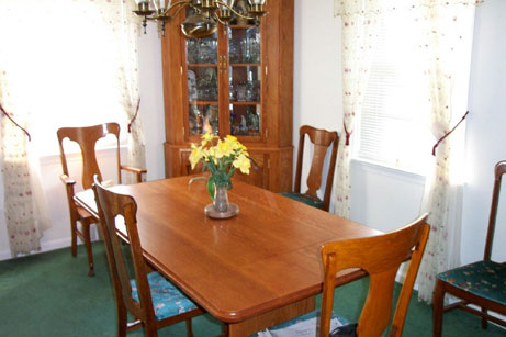

>Good Afternoon Chris,
I built our trestle dining room table as a matching piece to other dining room furniture. It is of quarter sawn white oak. We have a large family, and I wanted to insure the furniture was rugged as well as good looking. I chose not to "distress" it with chains and deep scratches, gouges and black paint flecks under the top coat of finish. I used a satin poly, steel wooled and tacked between coats. The table accepts two 12 inch leaves.
George
