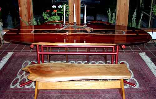

>I made our dining table from a couple pieces of book matched 6/4 cocobolo, finished with automotive acrylic lacquer, around 20 years ago. It has remained absolutely stable, but has acquired some dryness cracks due to sun exposure. Although I'm very allergic to the natural and dust, one it's finished, there's no problem.
Clint
Re: Cocobolo Kitchen Island top?
The table
Clint Searl, at the base of Haycock Mtn

Bart Goldberg
Impressive table!!!
Bart Goldberg
