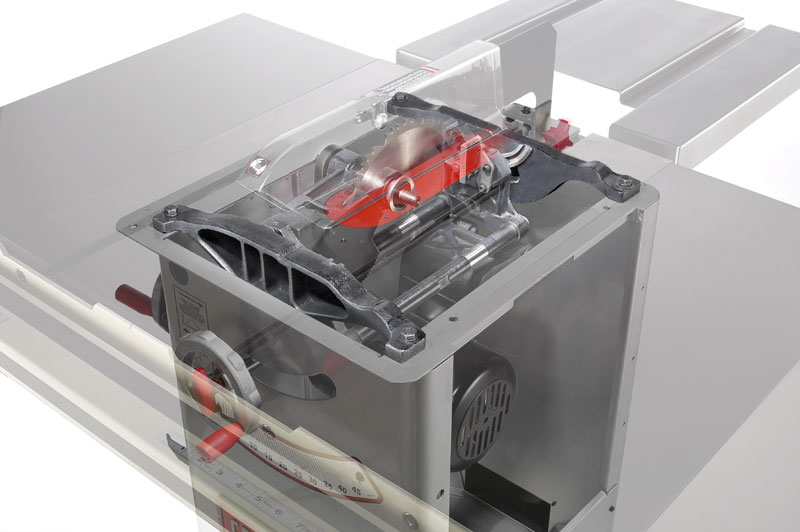

knotscott
>... "On another note...if you look very closely at the new Delta and Grizzly hybrids, I think you'll see that they come from the same factory. All the fixtures are the same, as are the dimensions and architecture, with the only differences being the flare at the bottom of the Grizzly, and the styling on the motor covers. The internals look to be exactly the same as my Craftsman" ...
Stuart - that's not correct, and I think it's worth clarifying for others. These three saws have very different trunnion systems....the Craftsman has cabinet mounted trunnions with oversized connecting rods, the Delta has conventional table top mounted trunnions with the oversized connecting rods, and the Grizzly G0478 has one piece cast blade shroud mounted to the table top. The Delta's motor and drive system appear to be the same as the Craftsman, but it's alot different than the Griz. Grizzly's website has a pic of their motor and trunnion mounted to the top.
http://images.grizzly.com/grizzlycom/pics/jpeg500/g/g0478_det4.jpg
