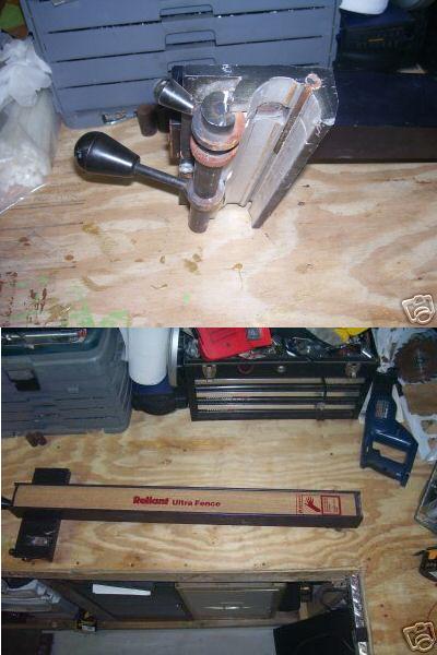

>Hello Everyone,
I new to this site and hope you don't mind if I pick your brains every now and then. Righ now, I'm desperate to get some info on this table saw fence.
I'm trying to find out if a Reliant Ultra Table Saw Fence (Part Number(?) R2056) will fit the standard tube rails of a Delta 34-670?
If anyone has ever heard of this Table Saw Fence. please let me know where I might get more info on it. I would be greatful.
I found this on ebay and was hoping to replace the the old one I have that won't stay aligned properly.
Thank You All
Walt Ballard

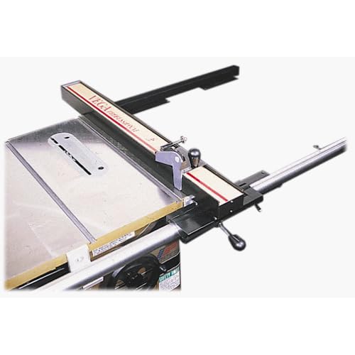

I don't know....
Hoa Dinh
>but it looks suspiciously like the Vega fence.
-- Hoa

Don't know how much help this will be…
Rod Peterson
>As I recall, Reliant was a house brand for Trendlines, a woodworking tool suppler who went belly up ≈five years ago. They had a brick & mortar line of stores under the name Woodworkers Warehouse, who also went belly up a little later. I doubt you'll be able to find much information about any of their stuff.
The good news (and just a wild guess on my part) is that the head in your picture looks much like an old Delta JetLock fence, which was cloned by a number of Pacific rim manufacterors as they developed their various lines of Delta Unisaw clones. I would be surprised if the parts weren't interchangeable, at least so far as the rail is concerned.
I guess the best bet would be find someone local with a JetLock (not to be confused with Jet) and see if it fits. If you haven't already purchased it (wasn't clear from your post) you may be better off with something else. I've seen JetLocks on ebay quite often.
Good luck.
Rod

Martin McNamee
>I agree with Mr. Dinh, this looks like a Vega fence. I highly doubt it will correctly fit (be to large) the tube on your current saw.

Rob Sandow
>Rod's right about the brand name, it's the old house brand of Woodworkers Warehouse. Almost anything with that name on it was junk. I would stay away from this one.

Howard Acheson
>The Reliant Fence was manufactured by Vega and branded for Woodworker Warehouse--who has been out of business 6-8 years. It's standard Vega Utility 26 fence which is still sold. It has its own front tubular bar and a square rear bar. It will not fit on the bar of a Delta fence system.
It's an excellent fence system. You can get parts from Vega.
