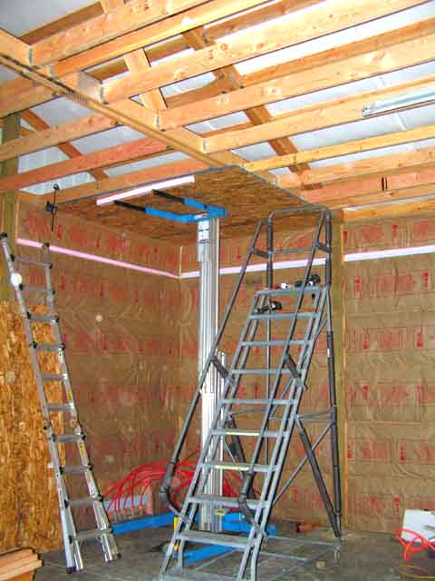

>Ultimately I decided on 15/16" CDX panels for my shop ceiling. The thinking is I can screw or bolt anything anywhere into the ceiling this way. I will spackle the screw holes, calk the seams, and paint them white to help with light in the shop.
I was able to borrow the Genie lift for a long while from work, which makes short work of lifing those panels into their respective locations, and doesn't cost a thing in rentals!
A couple weeks ago a friend and I basically finished out the wall insulation, I still have 3 spots to put up insulation, 2 of which hold quite a lot of lumber. My plan being to ceiling and draywall a section of the walls you see in this photo so that i can "bury" that area in wood and stuff from the garage and start getting moved into my new shop.
With my $99.00 35,000 btu Redi torpedoe heater running with those open joists for 2 hours, the temperature at 6' went from 30 degrees to about 44 degrees. Up in the joists I was sweating, so I am hopefull with a ceiling to hold the heat a bit lower, I will be able to warm the place up enough to work in if not glue in.

>Alan,
The shop looks great. A question and possible caution. I'm a little concerned that your trusses might not be rated to carry anything more than the ceiling. Are they able to carry more? If so, go for it but might be worth checking into. However, putting the OSB on the walls might be more worthwhile. Just a thought,

>My trusses were engineered to be 10lb per squarefoot bottom load. I put up 2x6 joists with simpson hangers. Distributed over the whole area I could up over 3 tons into the attic space. But since I went with a 12' interior wall height, I figured I could use the perimeter walls for my lumber storage. The girders are 2x6 blocked at 24" spacing. This gives me a solid mount for cleats to hang my wall cabinets on.

>Alan
I did the same thing in my shop. I nailed mine. I also cut 2" wide strips to cover all the joints and nail holes before painting. It looks like a raised pannel ceiling.
