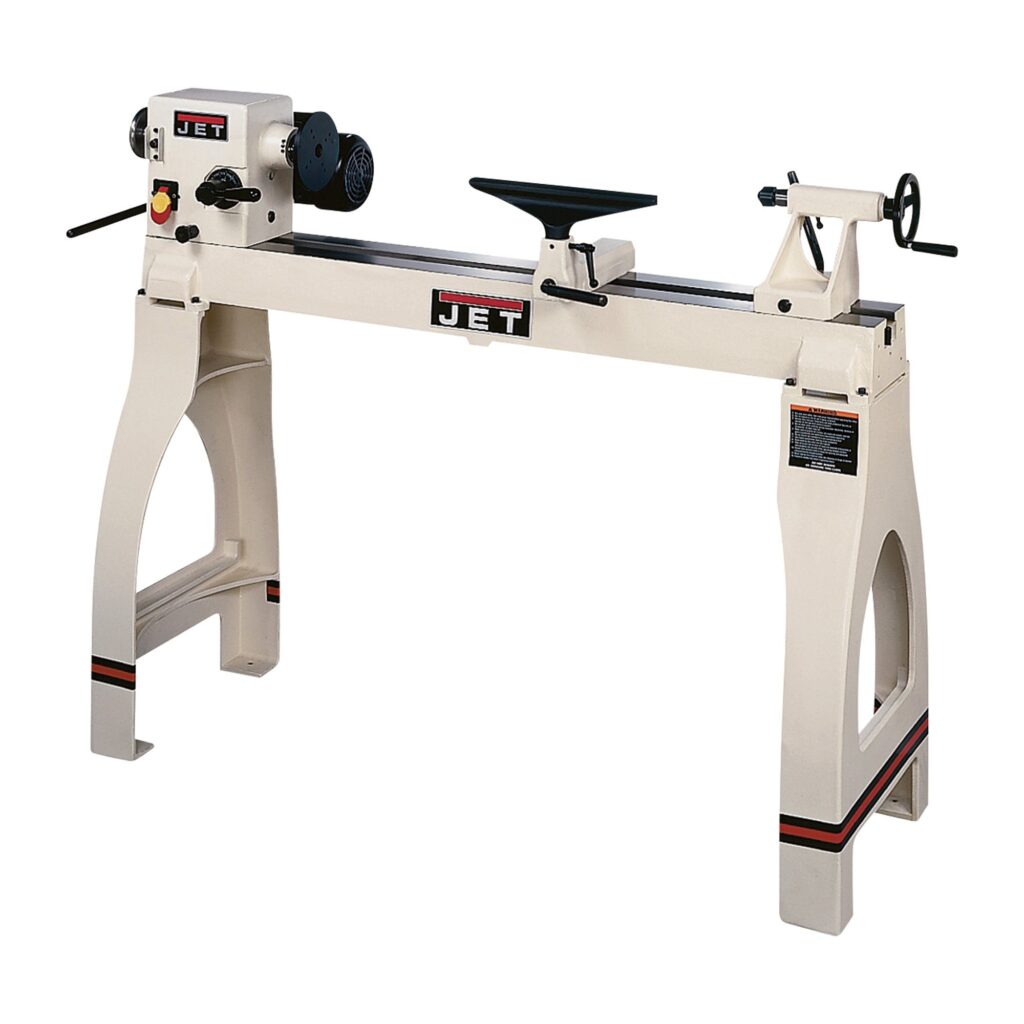

Here’s a sample review of the JET JWL-1442VS Wood Lathe that you could use on a blog, woodworking site, or forum:
Review: JET JWL-1442VS wood lathe
When you step up from a small benchtop lathe and need more capacity for spindles or larger bowls, the JET JWL‑1442VS Wood Lathe is a machine that frequently shows up in mid‑range workshop lineups. It combines a good balance of power, rigidity, and versatility that can serve both serious hobbyists and light‑production settings.
Select for full size
First impressions and build quality
Right out of the crate, the build quality of the JWL‑1442VS stands out. The lathe features a heavy‑duty cast‑iron bed and legs that lend substantial mass and stability to the machine. This solid foundation helps reduce vibration during turning, which is critical when you’re working on larger diameter blanks or detailed surfaces. (WoodCentral)
The overall design is utilitarian but functional: the headstock can slide along the bed and pivot 360 degrees with positive stops at common angles, enabling easier bowl turning and outboard work. (LVL1)
Performance and features
Powered by a 1‑horsepower motor with a variable speed range from roughly 450 to 3,000 RPM, this lathe handles a wide range of woodturning tasks with surprising competence for its class. Variable speed is achieved via a Reeves drive pulley system, which lets you pick from distinct speeds while the machine is running — though it’s worth noting that this type of system isn’t as smooth or infinitely variable as an electronic controller. (LVL1)
Here are the core specs and capabilities that woodturners will care about:
  • 14‑inch swing over the bed and 42‑inch between centers, giving you real capacity for larger projects. (WoodCentral)
  • Positive indexing on the spindle for fluting or repeated detail work. (LVL1)
  • Built‑in spindle lock and quick‑release mechanisms for easier accessory changes. (ManualsDump)
  • A hollow tailstock that allows you to bore long holes for lamp bases or similar applications. (LVL1)
These features make the lathe capable of everything from basic spindles and bowls to more complex hierarchical work.
Pros
  • Robust construction — The cast‑iron bed and legs give the lathe a stable platform that minimizes vibration and enhances cutting control. (WoodCentral)
  • Good swing and length capacity — 14‑inch swing and 42‑inch between centers cover most hobby projects and many professional tasks. (LVL1)
  • Versatile headstock movement — Sliding and pivoting headstock improves accessibility and ergonomics. (LVL1)
  • Practical feature set — Indexing, quick accessory changes, and through‑bore tailstock increase utility. (LVL1)
Cons
  • Reeves drive limitations — Some woodturners note that pulley‑based speed selection isn’t as responsive or fine‑grained as electronic variable speed. This can make low‑speed work on large, off‑balance blanks more challenging. (Reddit)
  • Weight and footprint — At well over 300 pounds, this lathe isn’t something you’ll move frequently — once it’s in place, it stays there. (WoodCentral)
  • Parts availability concerns — In the used market some owners report that replacement parts for this model (especially older versions) can sometimes be hard to source. (Reddit)
Who should buy it
The JWL‑1442VS isn’t a beginner’s mini lathe, nor is it a full commercial‑grade powerhouse — it sits comfortably in the middle. If your projects include medium‑to‑large spindle work, bowl turning up to 14 inches, and you value rigid construction and solid feature set for the price, this lathe will serve you well. Its mechanical simplicity also makes it straightforward to maintain.
If your priority is electronic variable speed control or you routinely do very large bowl blanks at extremely low RPMs, you may want to compare electronic variable‑speed models or higher‑end lathes. But for most hobbyists and light professional turners, the JET JWL‑1442VS offers a capable and long‑lasting machine that’s ready for serious work.

  1. Under-powered and Reeves drive is unreliable, doesn’t turn slow enough at lowest setting. Not recommended unless someone gives it to you.
