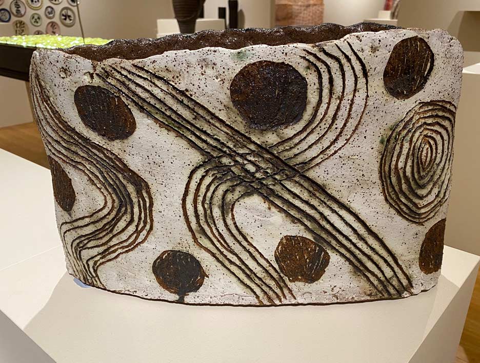

For the first time I began to understand Aboriginal art, its symbols and stories. Much of this is about maps ... landscapes. The circles are usually about women. There are streams and mythical creatures, such as a snake. There are flowers and trees. All symbolized ...
The symbols adorne more ...
What I would like to do is incorporate the essence of Aboriginal symbols in wood (not in colours, however), in boxes for example. In other words, using texturing in the wood to illustrate the symbols.
Your thoughts on techniques?

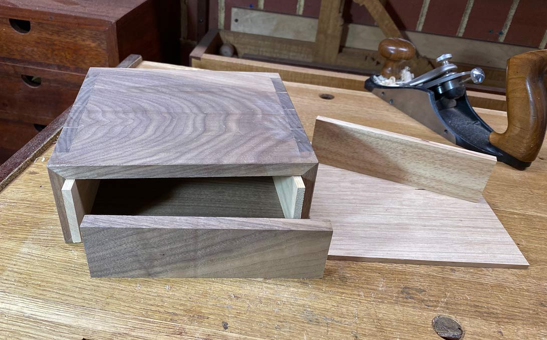

I am quite far with the first box. It is to be a mini-chest ... single drawer chest. Small - the one below is 190 x 175 x 70mm. (7 1/2" x 7" x 2 3/4". Case sides are roughly 1/2"). This may be used for what-ever, but could go on an entrance hall table to keep keys inside. Just an idea.
I scrounged about the workshop for small sections of timber. This one is USA Black Walnut. Work done this weekend, and the drawer to complete ...
Mitre through dovetailed case, with 12mm sides ...

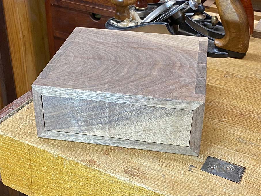

The case is glued and planed, but unfinished ...
After the drawer is made, the plan is to texture the sides and rear panels in a way that will compliment the figure on the top and drawer front (which appears too nice to hide - I shall put some finish on this first to decide).
