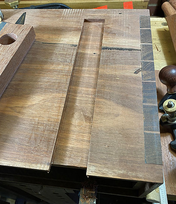

sliding dovetails
One of the obvious benefits of a sliding dovetail is that it creates a strong joint. Another is that it creates a very compact joint.
This entire case was built from mortice-and-tenons and sliding dovetails ...

Parallel vs Tapered sliding dovetails
Jim, it was not my intention to showcase the piece of furniture, but rather to highlight the joinery. That piece was mentioned on the forum about a month ago, when it was published in FWW magazine.
The other factor I wanted to draw attention to is parallel vs tapered sliding dovetails.
For the purposes of the construction of that piece, where the sockets were relatively short, they could be made parallel. However, when a socket is long - say the width of a case - then tapered sliding dovetails are better used .... otherwise it would be a nightmare to fit together.
Tapered socket ...
Link to make: http://www.inthewoodshop.com/Furniture/EntryHallTableForANiece8.html

I may be guilty...
Jim Matthews
...of tugging on Superman's cape.
The most intriguing aspect of this is that the "strip" of material housing the multiple sockets appears to be applied to the external panels. That implies that the joinery van be completed in a discrete step - without risk to the show faces.
This is fiendishly clever.
(I'll be stealing that, thankyouverymuch.)
