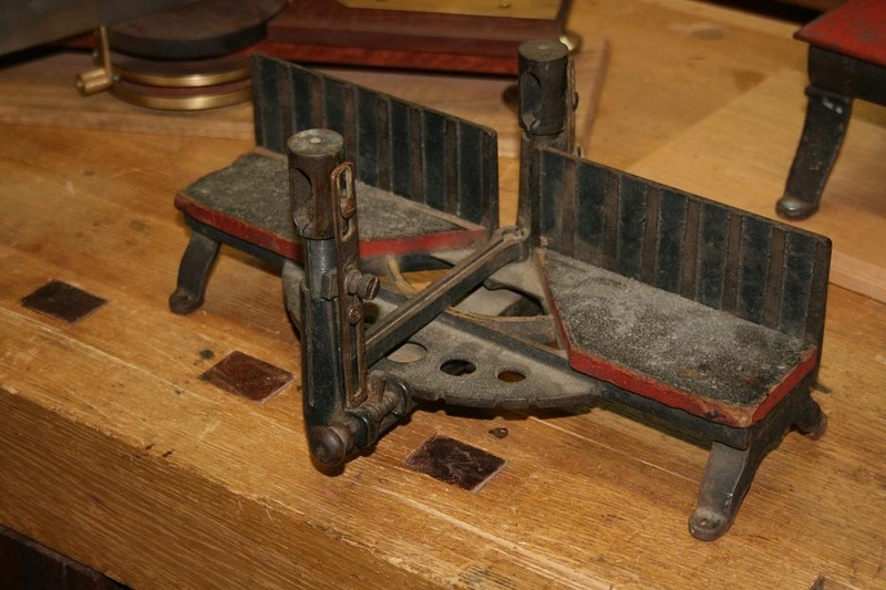

I do still have one Millers Falls #15 1/2, which is a tiny one, for moulding. It came like this ...

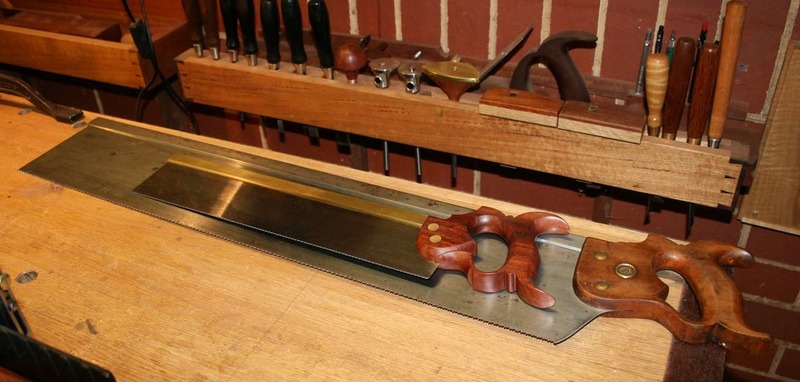

I needed to make the 14” x2” saw as well ...

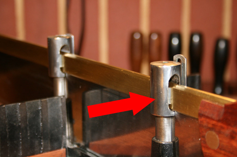

Beautiful job on the restoration! A real showpiece! Just because...
Wondering - how did you get the upright guide posts so shiny looking? Did you just pop them in a lathe to spin them, run through the SiC paper grits and then polished, or did you get them plated?

John, deburring wheels (impregnated nylon) are great for cleaning and polishing steel. I have them in several grits and chuck them onto the drill press. This is one reason why the drill press is one of the more important machines in the workshop.

You are correct when you note how rare these are .... thanks to Chris Schwarz ... whenever he posts something ... ! It took me more years after this to find this one, for affordable Dollars, but it came with a few welds and issues.
This is the difference in size of yours and mine ...
I wrote up the restoration, here: http://www.inthewoodshop.com/ToolRestorations/MFMitreboxRebuild.html
For those who do not go to this article, one trick I used to fine tune the running of the saw, so that it cut precisely and smoothly, was the addition of nylon blocks ...
And the difference in size of their saws ...
