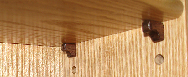

Well....I'm guilty too
I used Blackwood shelf supports in a piece for the same reason you used Ebony. I too like to not quite hide some special feature in a gift piece even if the gift is to wife. It may be years before my grandchildren find all the things I have included in their pieces. Most obvious is a coin with the date of construction.
I like the shape of your support and will likely use something similar some time.

I like the look of those as well, and that cabinet....white ash?
