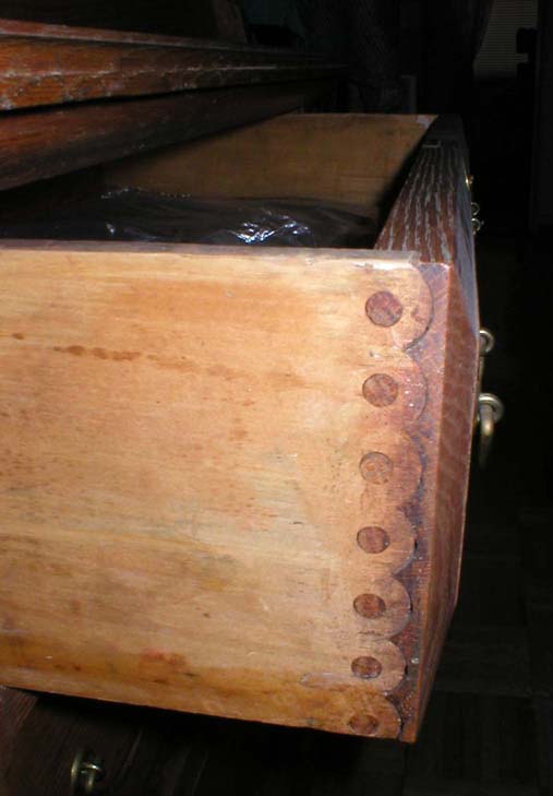

A friend has a piece of furniture that she calls a lowboy. It's fairly large piece with big drawers and a hidden drawer behind the bottom rail.Deep carvings and curved elements. I was checking out one of the large drawers and noticed the half blind dovetails had the rounded profile on the inside that you see with router made dovetails.The fronts are solid hardwood(mahogany?) as are the sides. The tails are perfectly uniform with no marks from marking tools. She assured me this piece is old. It's been in her family a least 40 years and she guessed it was alot older.
What I'm asking is how were these dovetails made and how old could this piece be? How long ago did factories use a circular cutter to make dovetails?Or could their be some other reason for the shape?---Jack

I don't have an exact date off the top of my head, but by the 1890s most machinery we know today, with the exception of CNC existed. By the 1920s most factory made furniture likely had machine cut dovetails.

Machine-made dovetails date from c. 1900
Steve Elliott
The first successful method of making machine-made drawers was the Knapp joint, which used a series of circular shapes with a peg in the middle. These joints were used beginning in about 1870 and were very common until about 1900, when mechanized methods of making dovetailed joints were developed.
If you have seen pictures of Steven Thomas's Loopy infill plane, you'll remember the distinctive Knapp-type joints that connect the sides to the sole.

Definitely by 1960
Ian Neuhaus (in Sydney, Australia)
Jack
I live in Australia, I'm 55 this year.
When I was about 4, my dad bought a Miller Falls tailed router and around the same time a Stanley dovetail jig -- which cuts the standard no layout, evenly spaced, half blind DTs.
Given the distance between Australia and the US and our different voltage (240, not 110) my guess is the same tools were almost certainly available to US home WW in the early 1950s.
"40 years ago" is 1970, much older is say 1960
If she was in Australia, and if my dad had built and sold stuff out of his home shop, he could have built it any time after about 1959.

Powered routers go back about a century if I recall correctly.
I have a couple of Stanleys routers from the 50's (these became Bosch when they bought out Stanley Tools - you can see the resemblance even now). My nickname for them is "R2D2". :)
There is an advert in an on 1950's UK woodworking magazine in my library that must be for one of the first home workshop jigs for power-cut dovetails. It uses a corded drill and a jig very similar to those now used with powered routers. I'll try and dig it out and scan the image for here.

Drawer Example - Knapp Joint
charlie belden
Inventor Charles B. Knapp of Waterloo, Wisconsin patented the first joint making machine in 1867. In 1871 Knapp Dovetailing Company of Northhampton, Mass, put more refined machines in commercial application in furniture factories on both the east cost and midwest region. Could do 200 drawers a day.
