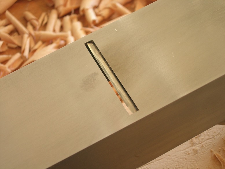

Marc in Luxembourg
>Wiley,
First the camber:
Re: Fore/scrub planes

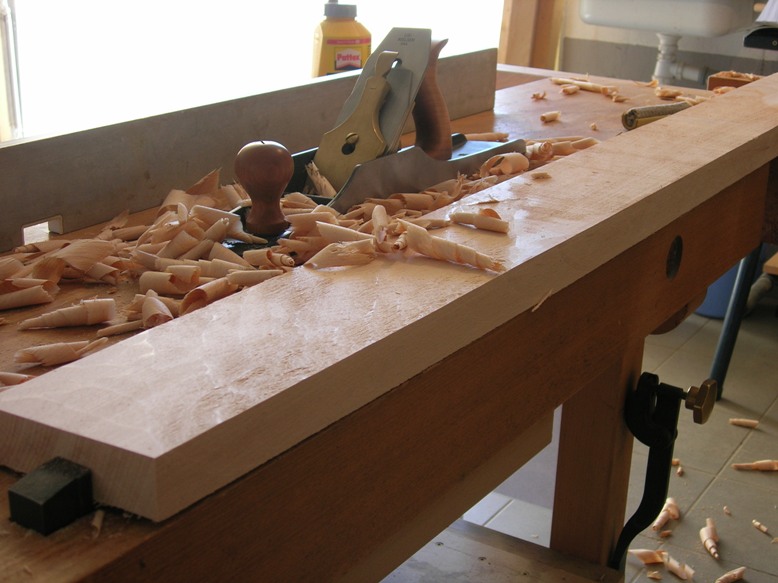

Marc in Luxembourg
>Not sure what action photos are, but here I scrub on the diagonal:
Marc in Luxembourg
>At last some long strokes with a typical shaving. For this I adjust the depth of cut to a less thicker shaving. After the LN6 I pass to the #8 which has a more moderate camber and finish with a #7 which has a smoothing plane camber.
I hope I could help, but aren't sure I photographed what you expected :-)
Marc

Marc, thank you
Wiley Horne
>What I was hoping to see--and can partially in your photos--is the pattern on the work which is generated by the cambered blade.
I think most readers on this forum are familiar with using a cambered blade. But for any newcomers who aren't (and we were all newcomers at some point!), the power of the cambered blade in a flattening operation is just amazing.
