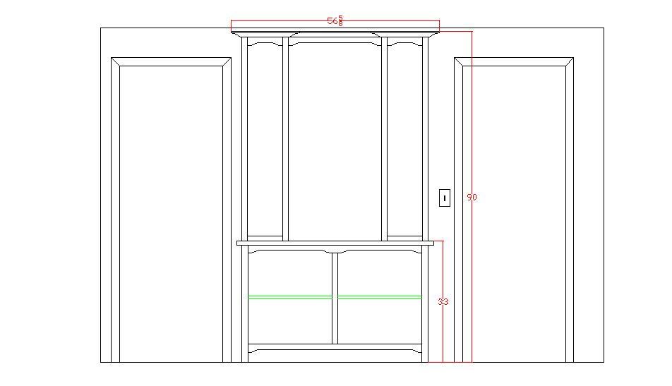

>You can get the gist of what I am working on designing here with the simple sketch below. I have searched some on-line for a drawing or clear pictures of the Greene & Greene cloud lift. It will be a fairly important part of the design, so I want to get the scale to look right. I would be interested in any design suggestions you have. The upper center section will not be as deep as the upper outer sections of the book shelf, and the drawing still does not show the shelves, but you can get a general idea of the proportions of the piece, and where it will set between two doors in an upstairs hallway. Happy Mother's day to all the moms out there :)

>You have 4 lifts over a very shoty course. I'd go with two at the very most over the run you have and width (or height) of the wood you have sketched. G&G is very simple and a mostly machine made style. One must remember this.

>Hi Moses,
All the other sources mentioned are very good. You really need to stare at a lot of original examples for a while to get the feel for it. There really isn't a "typical" G&G cloudlift-each house had variations on the theme.
To my eye, you have it a bit too traditional, and a bit too busy. I would be frugal about throwing them in. IIRC you work in AutoCAD, so I hope this suggestion makes sense:
Try offsetting the two horizontal lines about 1/2", 5/8" at most. Come in from one of the sides 3" or 4". This will be the center of the curves. From that point, draw a line at 45 degrees up to the other line. Trim away the lines you don't need, and put a fillet at the intersections. The radius of the fillet should be bigger than you think it should be, mess around with it until the 45 degree line is only about 1/16" between the curves.
Hope this helps,
Bob Lang

>Hi Moses,
The lowest horizontal member should be double in thickness. The upper section should not pass top of the doors more than 3" ~ 5" max.
Lastly, you may move the whole thing 2" to the right. This way, it'll be centered in between 2 doors; Better balance yet still room for the light switch.
Everything else seems in place.
My 2.00 Cdn. (1.80 US) cents.

>This will not actually be in the style of Greene & Greene, except that I think their interpretation of the cloud lift is most excellent. So the cloud lift is the only part of their design I wish to have some input on. But of course I like their style and at some point will be building pieces in the G & G style, I am just not going to put that much time into this shelf because I have other things on my list this year ;) Thanks for the input, I may re-think my design a little.
