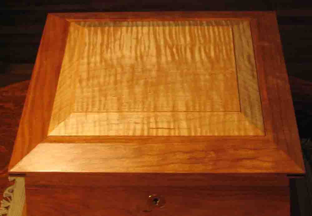

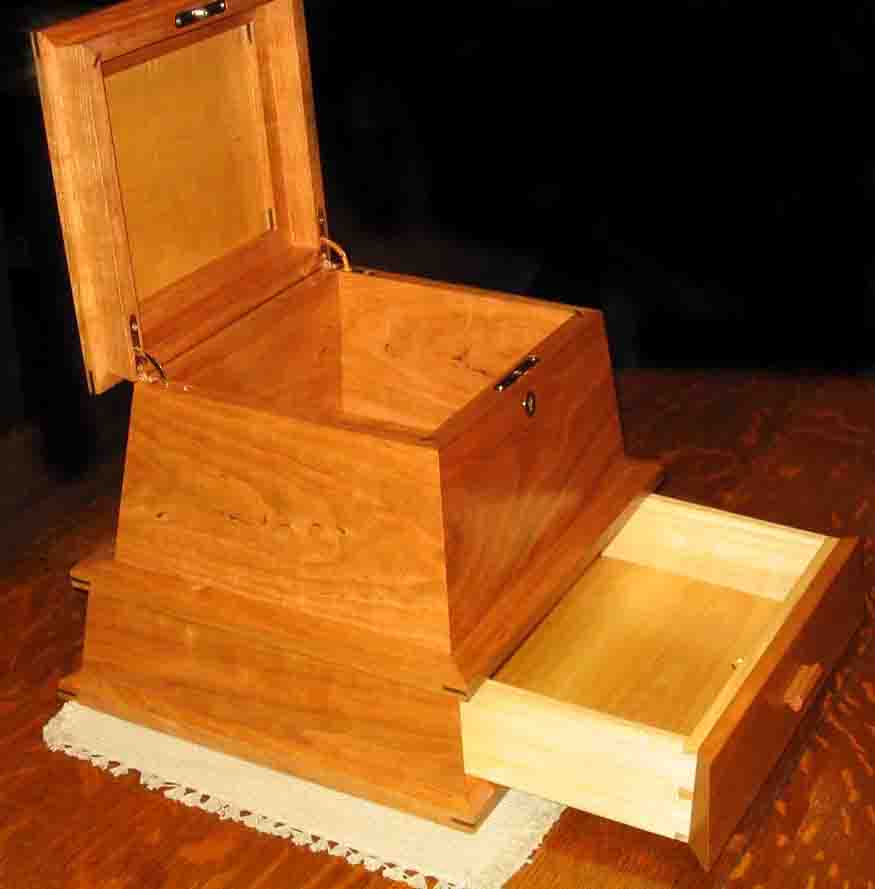

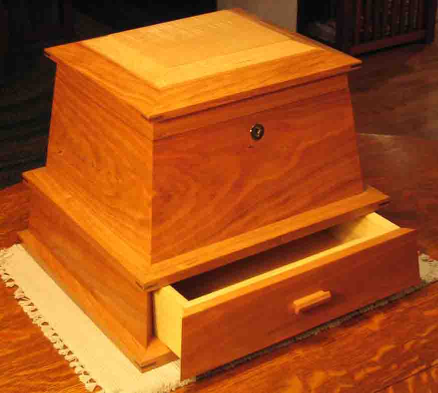

>A good friend of mine and an accomplished woodworker passed away prematurely a while back and his widow asked me to make something to hold his ashes. The pic below and in a couple companion posts are what I came up with. Not really sure how I arrived at the design. Pat (my friend) had an interest in Japanese tools and joinery, which got me thinking about the angled sides. I made several pine mock-ups using elements of different angles and proportions and this is what seemed most appealing of those. Made of cherry obviously, with walnut splines and a curly maple panel in the top. The drawer box is persimmon, which is a little unusual, but it was from a plank from a tree that Pat had milled and given to me to �see what I could do with it.� Certainly never thought this would be the use I would put it to.
All the elements are angled/beveled. The upper compartment is sized to hold his ashes, while the drawer is to hold his eyeglasses, wedding ring, and a few other keepsakes. The drawer front is mitered to meet the sides. I felt a little like I was �cheating� using a false front on the drawer, but when I started thinking through the details of blind dovetailing the drawer side into a mitered and beveled drawer front, I decided to just do the false front. All pieces of each �layer� are made from a single board so the grain matches, so if I messed up the joinery on the drawer front I was going to have to start over with all new pieces. Call me chicken.
Made with a combination of hand tools and. . .er. . .other than hand tools. Finished with oil, blonde shellac, and wax.
Sorry about the large image size/poor resolution. I stored the file in a smaller format, but it gets large again when I post it.

>Very beautiful work and very personal; it is truly a wonderful touch to have wood he milled incorporated. A fitting and worthy resting place; very few get so much care taken in honoring them.

>Dave ... outstanding piece of work. I'm sure your friend would appreciate your effort & the beautiful end result.

>What a tough project to have to build. You did a wonderfull job.

Nice work. There are a few times available to us to something really good for a friend. You took the opportunity and made the very most of it.

>Nice work.
My wife has her parents ashes in cardboard boxes in a closet, and I have kept putting off making some sort of more dignified vessel(s). Are you going to seal the lid to the box?

>Thanks Don.
I used humidor hardware for the upper part -- side rail hinges with integral stops, and a full mortise lock. The lid is not sealed, but it is locked shut (not that that kind of lock is impenetrable, but it keeps the lid from coming open unintentionally).

>Ashes in a DC bag -- now that's fitting.
I probably should have made clear that the ashes going in this urn are already in a metal box, so the urn is secondary (actually tertiary) containment.
