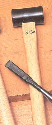

I use this guy because I use Japanese mortice chisels. I also have a 450g one for the big stuff. I won't hit the smaller (under a 1/4") ones.
If you�re using the western type I can't recommend a round "carvers" type mallet, then tend to glance off the side of a chisels handle IMHO.
I'd go with a jointers mallet as shown in others posts.

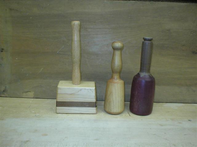

>I made these three. The one on the left is my first.This tends to misfire alot.You have to watch where you strike with it.I stopped using it after I turned the maple carver in the middle.That one is my most used mallet. Nice to hold and never misses.Plenty of power for most any work and light enough for delicate hits. When I want to whale on something I grab the purpleheart mallet on the right.I just made it for something to do one day but it turned out to be useful.---Jack

>Jack,
I'm glad that you posted this with the comment that you have problems with the mallet on the left of your picture.
I have one like this with a round handle and one similar to it, but with a rectangular handle fitted into a rectangular mortise in the head. I find the one with the rectangular handle much easier to use. I get a tactile feel of the direction of the head from the handle and don't "misfire" with it nearly as much.
I never really thought about it before and realized that the handle was the source of the problem.

>Hi Jack,
What is the diameter's of the 2 round mallets. I was talking to the guy at the link I provided and he said the medium mallet is 2 3/8 and the large was 2 3/4. I am leaning towards the medium mallet seeing I am a small guy but he said the large would be better for chopping mortises in hard maple like I'm doing or "whaling" as you so called put it :)
Re: Mallets and Choping Mortises *LINK*
Jack Guzman from Maine
>My small mallet tapers from 2 1/4"to 2 7/8".The big one is 3 1/4" at it's thickest.---Jack
