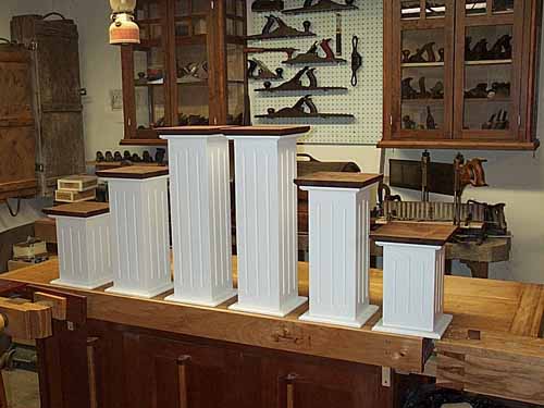

>Last week I think TOdd Hughes was wondering what mdf was, and I ended up buying some Monday evening, thought I would show him what it looks like ;) It cost about double what I expected, over $17 for a 4x8 sheet of 1/2" mdf at Menards. Our church is putting poinsettas in for Christmas, so they asked me to make some plant stands.
Design content; All the pews, pulpit, and tables are made with a white painted base and dark stained wood top on them, so I opted for this design to match. I decided not to contrast the current furnishings so the point of interest would be the plants on the stands and not the stands themselves. I started with the figure of 6", which is what the pots will be; they said 6" pots, so I figured that means 6" diameter, although I didn't double check it. I decided to make the columns 6" square, and then used the golden mean to make the smallest column a "golden rectangle" (excluding the base and top) , and increased the height for the taller columns in 6" increments. I drew it up on cad and it looked okay to me so I went with it.
Hand tool content; minimal hand tool use for this project, although I did drive all the screw with a Yankee screwdriver (the columns are biscuited together, and the bases and tops screwed on to the columns). And the air dried walnut tops, after power planing to clean up the faces and power sawing to size and beveling with a r**tah were hand planed and not sanded; a beautiful exercise with my #604-1/2 and a freshly sharpened Hock iron for the tops and a #18 with a Hock iron for the bevels and edges. And the columns are painted by hand, and the tops finished by hand. They'll be delivered today, we'll see how people like them tomorrow ;)

>Moses, thats a nice project good looking too.
I've worked with mdf in the past and found it easy to work with.
There is a guy (at least one) here in Houston that has a CNC operation that makes what looks like conventional interior panel doors etc. out of MDF they look real good painted and unless you were there when they were installed you would be hard pressed to tell the difference.
I understand they load up this huge table with door sized slabs of MDF and the machine moves overhead accross the slabs making a series of router cuts with smaller and smaller bits until you have these nifty looking doors or whatever it was you desired.
not exactly hand tool work but still impressive.

>Very nice columns indeed Moses. I don't understand one dang thing about how to use the Golden Triange, but apparently it works well for those that do. So how'd everybody else like them?
