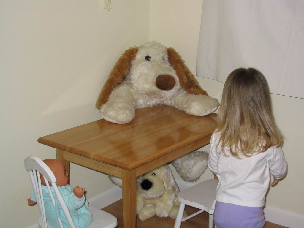

>Dang... I had a long message all done up and lost it...
Here's a short summary, as I'm not willing to retype it all now.
The latest big project was a table for my daughter. Say 24dx34wx20h out of QS Syc.
I only have a Jet contractors say with an Incra fence and attached router table, using same. A Jet 16" bandsaw, floor standing drill-press and a 12" planer - along with the LN 62, 60.5 and assorted sanders and misc tools.
I thought the table turned out pretty nice.
Stock prep for thicknessing was done with the 62. Flatten one face and run through planer. Since the Syc gets all torn up through the planer, the faces are resurfaced after planing by hand.
Straight line rip on the TS and final edge joint with the 62 where needed.
All the flattening and table top finish prep was done with the 62. So was the edge jointing for the top glue-up and the chamfer on the edge and end-grain clean up - the three blades makes this possible. The 60.5 was used for a few smaller things, like trimming the tennons for fit - a rabbet would have worked better - but oh well - a chisel works for clean-up where the plane can't go.
A 164 would have been great a few places, as I wouldn't have to have flattened as much of an area, but, again - oh well - it wasn't that much of a tribulation.
The tapered legs got burned running them through the TS, esp the first one - not fast enough. Normally this would result in a sand fest, but the 62 cleaned up nicely.
The first top turned into a bit of a problem child as it was to be edged with Walnut. After abandoning it because of lack of time, and the wood was cheap, I resawed it into "1/4 material and I've been cranking out about a dozen boxes with 1/4" box joints for Christmas and other presents/gifts. I've been playing with finishes etc for a while - hand rubbing Poly and the like. I've also been experimenting with lid styles - I'd like to avoid putting hinges on the boxes - because of expense and time/effort constraints mainly.
A weekend or two ago, I did a "replacement" pull out drawer for my wifes baking supplies - flour etc. It was out of poplar and required a fair bit of cup removal. The old one was a piece of trash, and left more than 2" unused in the back of the cupboard. Small trivial project, but nice to get something done in a single Sunday while also wathing my 3YO.
Anyway - I'm looking to do a coffe table with light box next, and then perhaps a dining table with a dozen chairs. But I want the leigh FMT before I do that as I'll be doing more than a hundred M&T joints and I'm lazy. (The wife wants me to do a doll cradle too, but I'm not too motivated yet. *grin*)
Practically, the table/chairs project is a *long* way off. I've got a bunch of half finished projects, like a silver box to complete first and home stuff, like sheet-rock etc. (But I can dream about quitting work and just working on it, can't I?)
So, I'm not a huge professional, but I think I do OK. I don't have a huge arsenal of toys, but I've got more than just the total basics. I'll probably buy say, three more planes, but I can't see having more than that. (Dedicated smoother, jointer, and rabbet.)
Until then, I can certainly make do with what I've got. I have to work-around stuff more than occasionally, but it's not that much of a tribulation.
