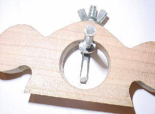

>Make your own router. A router shaped piece of wood, an eyebolt, wingnut, and an allen key, ground to look like a router cutter. I'll see if I can find some pictures I've saved off the web, or I'll take a pic of mine later.

>You're about to convince me. Please do post some detailed pics of an OWT router. Especially give me more details on how to attach the blade via the bolt and wing nut. It's probably a fun and easy project.

Davy, here is the "clamp"
Angelo in Cornwall, NY
>This is my router, not yet finished. The clamp bolt is actuallt a thumbscrew. It passes thru a hole which has a slot cut around it on the throat side. The screw fits into the slot.
Re: Scratch Stock for dadoes?
Clamp close up
>I decided to grind down the sides...well just because.
