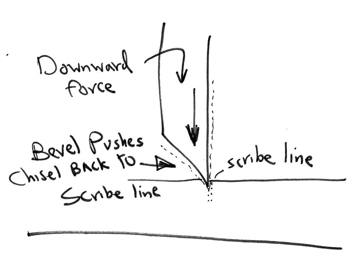

joel
>If you place the back of a chisel on a scribe line and give it a whack the bevel on the chisel will always drive the chisel back past the scribe line.
The solution is to place the chisel a fraction of an inch before the scribe line and give it a whack - driving it to the scribe line. Then you stop. THe amount the chisel will move back depends on the hardness of the wood. (see diagram)
Then you chip off one chip - defining the scribe line. With the line defined it is easy to chisel and chip out to the middle of the wood, flip it over and do the other side (There is a photo essay on my site on cutting dovetails using an anglemag which illustrates this - the anglemag is just a shortcut for sawing the chopping is the same)
Anyway - that's the way I was taught and I never pare to a baseline - takes way too much time.
IF you saw the waste first - and I only recommend this on wide waste - you can start at the scribe linve because there is no resistance of the bevel and the chisel won't move.
