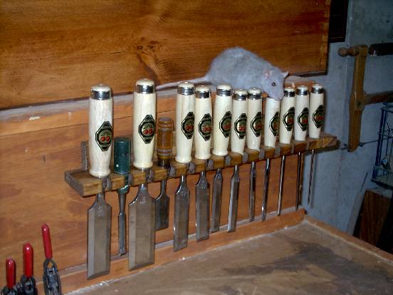

>This is the chisel rack I made this weekend. It holds my favorites. It is made from cheap pine scraps with cheap stain and cheap varnish. My other chisels will get an identical rack (bigger). The rack is held to the wall on a "lift out" cleat. The cleat is a piece (about one inch smaller all around than the rack's back) ripped at a 45 degree angle. One half attached to the rack and the other to the wall. It just sits solidly on that angle. Anyway, the rest is probably obvious. Thank you, to everyone who posted suggestions last week!!
-Will
P.S. Lonnie says, "Squeek!"

>Nice job, Will. I tried one similar to that but the pine broke between the cuts. I need to try again with some better wood.

I am aware that making the chisel rack from pine was risky. I think I made the teeth big enough that I shouldn't have a problem. However, if it breaks I won't be heartbroken. I will make the next one from white oak.

Your rack just proves you're not as hamfisted as I am.

Looks Good!

>Nice set of tools in a nice looking rack.

>Looks Great Will,
