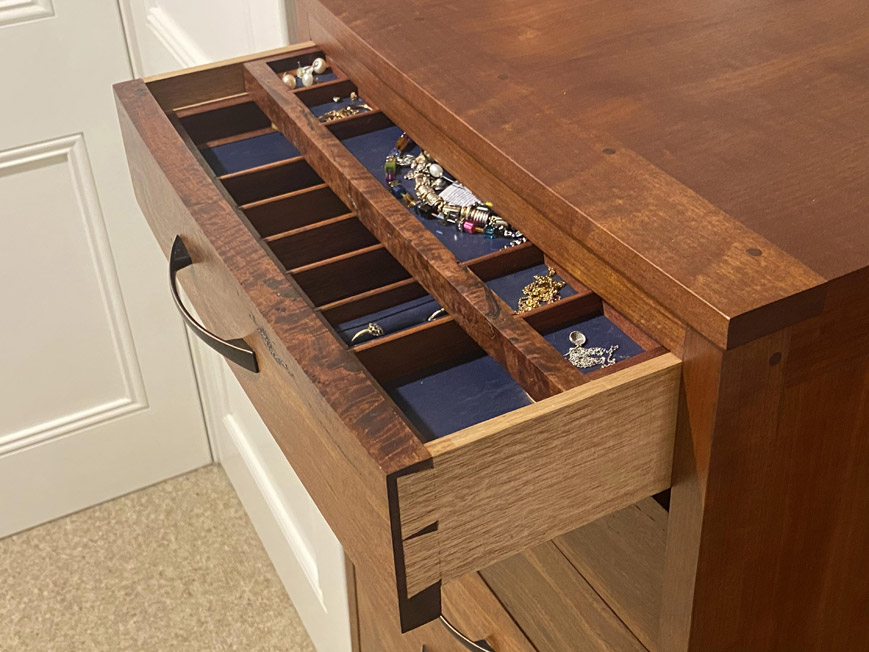

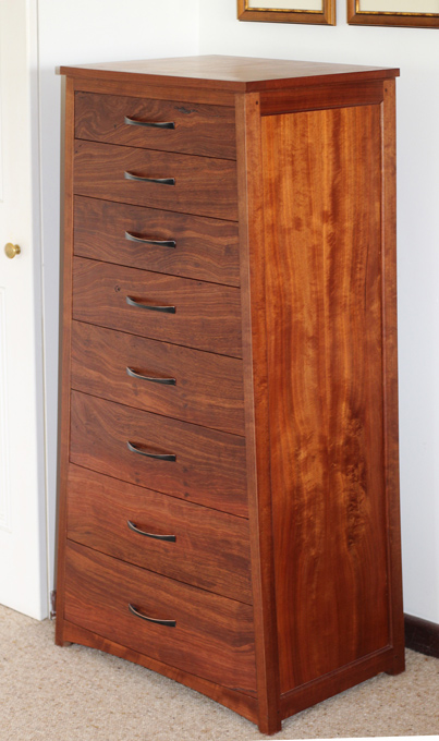

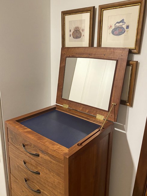

Barry, I built my wife this chest of drawer, nicknamed "The Lingerie Chest", 4 years ago.
No one picks it until I show them, that the top is a secret compartment ...
I used Brusso 95 degree hinges, which stop at this angle ...
They are assisted by brass stays, which I made myself ...
For good measure, the top drawer has a secret lock - a Quaker lock. When released, it opens to a set of sliding jewellery trays ....
