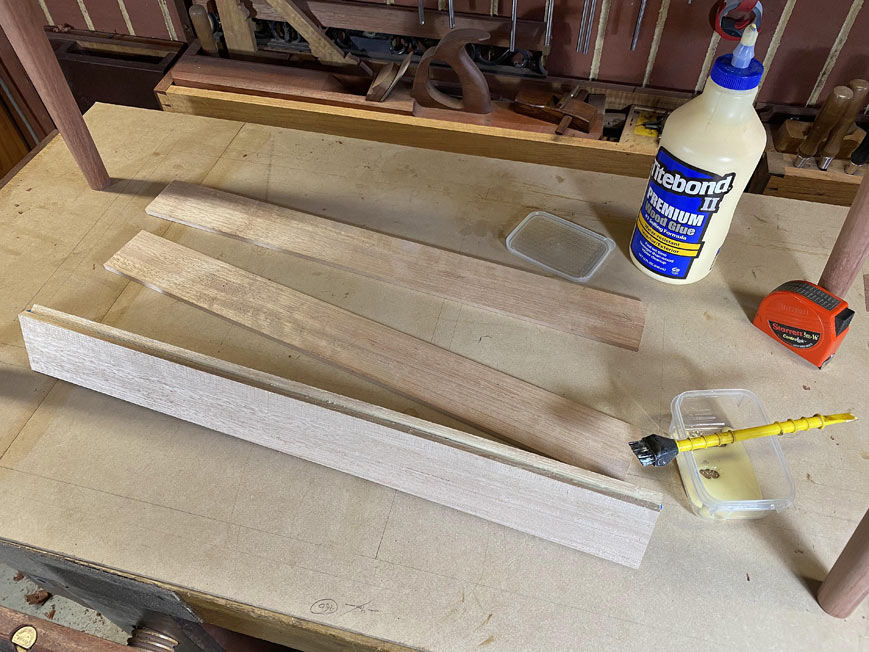

JL, glues dry out through the constant and frequent use of a bottle. I only open a bottle to decant some into a Tupperware container, which can be sealed by its lid.
I find that the glue in the container lasts and lasts. The small amount seen here could last a few weeks with ease.
The glue is spread with a silicon brush. Allow to dry and the glue peels off for re-use. I also made a bunch of UHMW spreaders.
