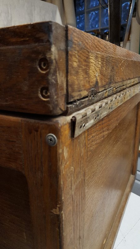

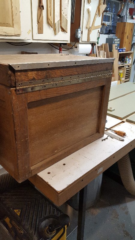

#1 Back of box. All the brass looking hinges need to be replaced. Aluminum angle stock is applied around the top.
#2 Back lid rail is split. Needs to be replaced. Somebody drove screws into each end to hold it together. Don't think I can hide those screw holes.

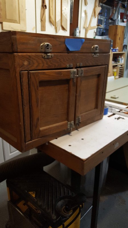

#3 Front of box. All the aluminum looking hardware needs to be replaced.

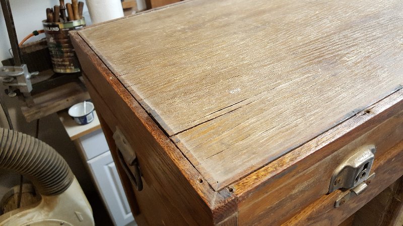

#4 1/4" plywood top needs to be replaced.

You can't hide those screw holes but you can make them less visible. I would take a piece of the same species of wood and cut plugs out of it ,drill for the plugs,glue them in and cut flush with the surface.

I'd get rid of those continuous hinges and put on some robust hinges.

I'd definitely make a new rail where the hinge mounts. As far as finishing, Mohawk makes toners in spray cans but, as someone suggested, you can add dye to your Seal Coat and accomplish what you are wanting as well. I'd probably use something like Arm R Seal to complete the finish.
Replacing the hardware might be tricky but the aluminum angle is easily found. Looks like a fun project.
