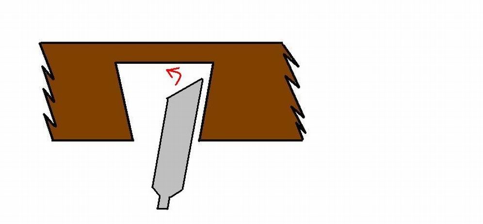

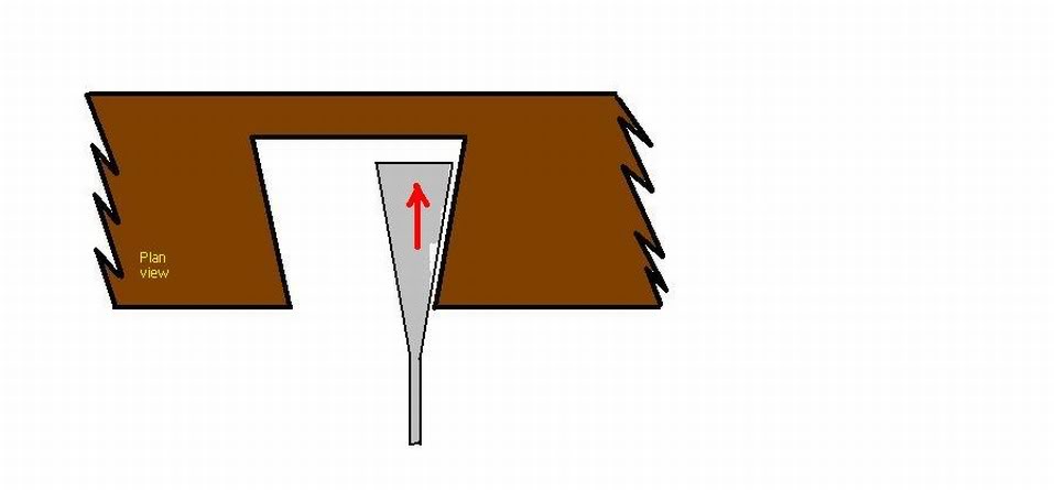

Bill, please try a fish tail chisel into the corner.
The issue I have with skew chisels is that you need to slice with them and this also requires several strokes ...
Plus you need two skew chisels, one for the right and one for the left corner.
On the other hand, a fishtail chisel is simply pushed into the corner ...
And you only need one. :)
Here is one I made out of a surplus preproduction Veritas 1/4" bench chisel (but several makers produce them) ...

Check my version of skew, not yours
Had I known of a fish tail that is what I would have made, and may still if I order any other unhandled Narex.
However, I do not need a right and left handed skew. I just change the attack angle and one works fine for me. Other's results may differ.
And, a skew ground as in your diagram was what I originally tried and found near useless for the reasons you give. . But ground at 14 degrees, near my dovetail angle, I wind up with the same ability to thrust as the fish tail. And that is exactly how my chisel is used.
I bet I made my skew quicker than your fishtail, which could be important to some. Just mount in a sharpening jig at 14 degrees, +/- depending on ones preferred dovetail angle, and grind away. took 5 minutes and done.
