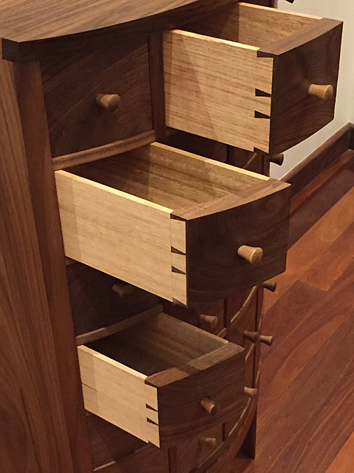

There are plenty of idiots out there, Bill. I've experienced gallery and show visitors pull drawers out of my exhibition furniture so far that they are caught by surprise when the drawer came right out of its opening, and they'd then drop the drawer on to the floor, even while I'm standing next to them. They always ran away as fast as they could after that and never offered to compensate me for the damage they caused to corners, the front face, etc. Having said that, some looked a bit sheepish, and others blamed me for not mounting the drawers on slides. I've never had a drawer smashed through their stupidity, but there's almost always been work required to repair the dings and dents.
As to the original question, like you, I think finding the answer only needs a bit of drawer opening and closing of existing examples to get a good idea of how much a traditionally made drawer can be extended. That applies to both a well made example of drawer and its opening, and a poorly made sloppy version. In general, I'd say a well made drawer in a well made carcase can be opened fairly safely up to roughly 75 - 80% of it's total depth, e.g., a 20" deep drawer can usually be opened something like 15" - 16". However, just because roughly 20% - 25% of the drawer remains within the carcase, there usually remains pretty good access the back of the drawer box, and things like place mats that pretty much fill the whole box don't need the drawer fully opened to put them in or take them out. Slainte.
