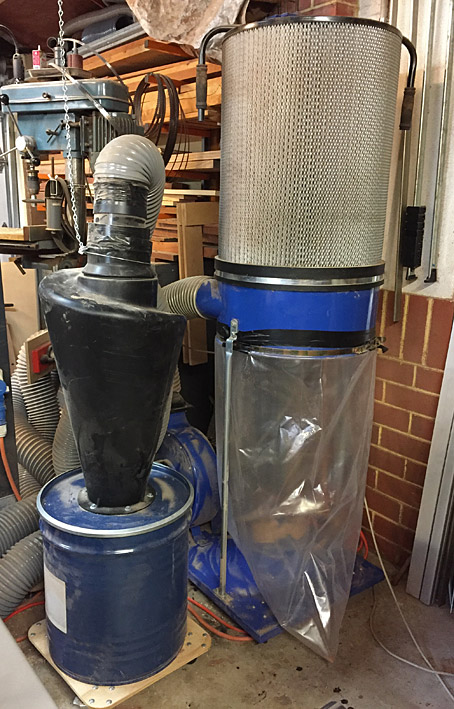

Bag changes
Mark, I did this several years ago. The DC is a generic 2 hp, as is the 1micron filter. This addition did significantly reduce the fine dust in the workshop ...
There is a Super Dust Deputy into a large paint tin (this has a sealing lock) collecting the chips.
These cyclones reduce suction, so keep your hose lengths short.
I took this a step further and replaced the lower bag (which is a royal pain to replace/empty each time) with another cannister (using the upper section of the bag as a connector) ...
There are blast gates for the table saw, jointer-thicknesser/planer, and bandsaw.
The set up does a reasonable job, but it is still only 2 hp and the 5" hoses are not as slick as pipe. My next upgrade is the dust control.

Yes. I generally get very little dust in the DC's bin .... and what goes there is because the dust going through the Super DD is forgotten and allowed to fill up its bin. More than two-thirds, and it heads to the DC.
