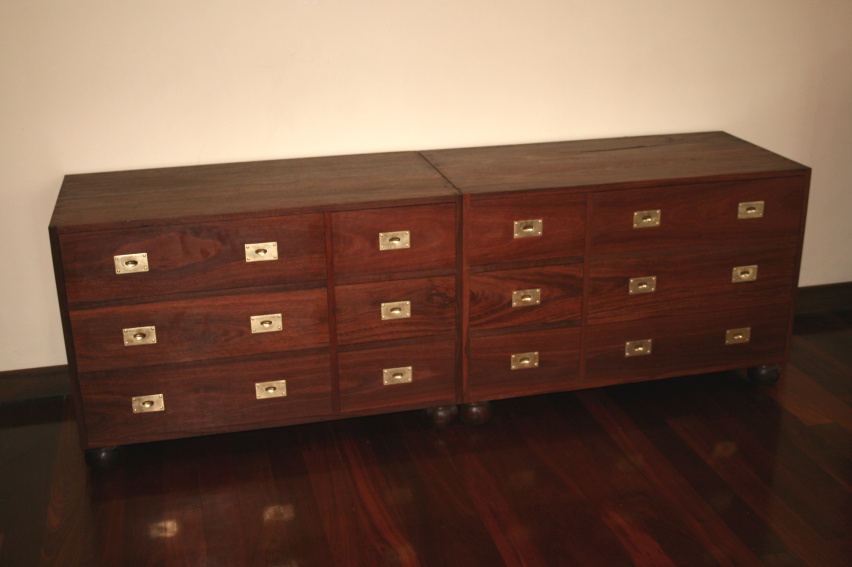

In 2011, I wrote a series of posts (on the Hand Tool forum only) that explored the different ways in which waste could be removed from half blind sockets. The build was two Military Chests (or Campaign Chests, as Chris Schwarz later termed them ... this build was before he road the Campaign trail).
There were 12 drawers in all, and the time issue (to remove waste) was important as the focus was on 'how long should it take to make a quality drawer from start to end?'. I did not document this on my website, but no doubt a Search on this forum would uncover all the details. What I recall was that it took me around 3 1/2 or 4 1/2 hours from whoa-to-go by the time I ended the last drawer. Also from memory, this was not far off professional time ranges, as reported.
