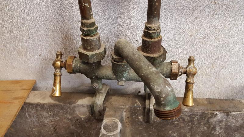

I have an ancient utility tub in the basement. I'm sure it's original to the house. The faucet is probably original too.
When I turn the hot water on it comes out strong then goes to a dribble. I turn it on higher so the hot water starts to come out strong again. Then it starts to dribble again. This goes on until it starts to stabilize and be a consistent strength.
I seem to recall someone once saying something about the washers causing that so I put a new washer on the hot side of this faucet. No change.
There are a few shutoffs upstream of this faucet for the washing machine and so on. Do those need to be replaced?
What might be causing this?

Sounds like the hot water pipe is being flushed clear of sediments.
I would cut off as much of the hot pipe and fittings as you can see and replace with PEX, Sharbite fittings and ball valves.

Any pressure regulators in the system? Maybe a pressure problem with the hot water heater since it’s hot water only.

Most likely the faucet washer on the hot side has failed and needs to be replaced. While you have the water off, I would change both.

Joe, I'm guessing this is the only hot water faucet having the pressure problem or you would have noted it. You said you replaced the washer on the hot side valve and it didn't change anything. I suppose it wouldn't hurt to look upstream at the other valve washers but I wouldn't hold out a lot of hope there.
My first thought looking at the faucet is how much trouble would it be to disconnect the faucet from the supply lines and run the hot water to see what it does. Of course without the faucet both hot and cold would run which could make a mess. I'm just wondering if there's something restricting the water on the hot side. Gotta be a way to test that.

Turn off the water and remove both faucets. It looks like there should be a clear show between them. There also appears to be some sort of drain screw in the middle. Clean it all out and if you still have the problem it is further up the system.

Long time plumber friend said it sounds like a loose or deteriorated stem washer on shutoff valve upstream of the laundry tray.

Don's friend may be right. I would check the valve you used to turn the water off to this faucet. It's likely to be the only one between the hot side of the faucet and the tank.
My plumber friend thought the individual shut off valves were stupid. To his mind, they were left sitting there for twenty years doing nothing until you needed them and the moment you touched them, they failed. Either the washer would disintegrate and go down the drain looking like black ink or the stem would start to leak. There is some truth in his observation. Be prepared to replace yours. Or maybe you will be luck and the washer will fail and get ot of the way and you can worry about it later.
Another possibility is there is a piece of trash in the line. I have flushed many systems through the bath tub faucet. It has high flow and no screen. If you laundry tub faucet is the only one affected it's likely the trash is just up stream and will not come out of a bathtub.
There were some water heaters made with defective dip tubes. They usually crumbled up and fell in to the bottom of the tank, but sometimes little bits of white plastic would come out of a faucet.

You may be able to listen tot he pipe using a screwdriver with the handle pressed against the bone right at your ear and the tip against the pipe or valve. Sort of a redneck stethoscope. Not sure if it will isolate the location for you but it might help. Let us know if you find the problem. I would start with the shut off valve for this faucet.
