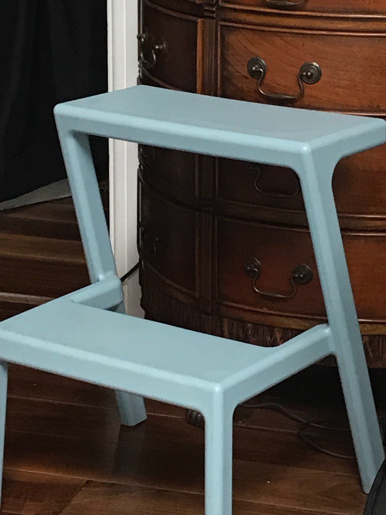

Walter Ahlgrim
My wife brought home this Ikea stool looked a little strange but I have grown to like them. I have stood on the top step 230 pounds it flexed a little. I fine the first step very firm.
https://www.ikea.com/us/en/p/maesterby-step-stool-brown-red-50402325/
