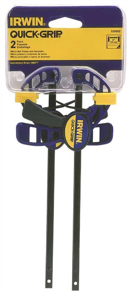

Stack several of them on edge and clamp them on each end with a low profile clamp and run them through your belt sander. You may need to build the custom clamps from wood, with wedges, if you don't have clamps that will fit. These would work right off the shelf.

Thanks for the time to reply! But I think they are way too thin for this. .400" I could perhaps make something to hold the ends but not sure how I'd support the middle.
