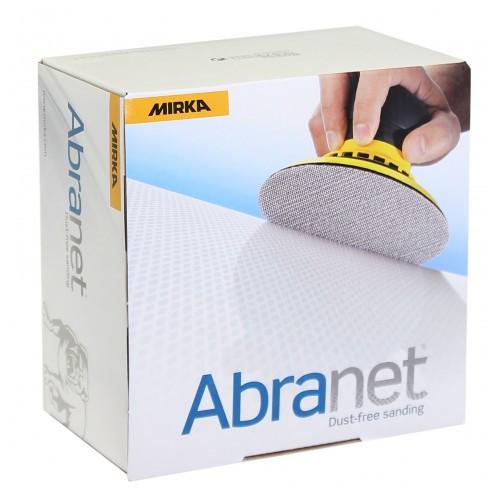

Abranet
Barry, you will find that all your problems go away if you use Mirka Abranet mesh.
These disks are made of impregnated mesh. They are durable, last many times that of more traditional solid disks, and do not require a special hole positioning. In fact, they optimise dust removal .... which is critical for smooth sanding.

Re: Abranet
Barry Irby
Thanks Derek, I will check on those. Good Idea.

Re: Abranet
AZ in Colorado Springs
The dust collection with those discs is very good.

BTW, the recommendations for Abranet are good. Just be sure to use the Abranet 'adapter' under-pad.

I also looked at the Abranet setup, but did not pull the trigger. I am milling it over in my mind. One objection I read was that it was as abrasive on the back as it was on the front and it wore the pad out. Then later I read about the interface pad. Sounds like the fix for that problem. One of my sayings is, Every solution has it's problems.
