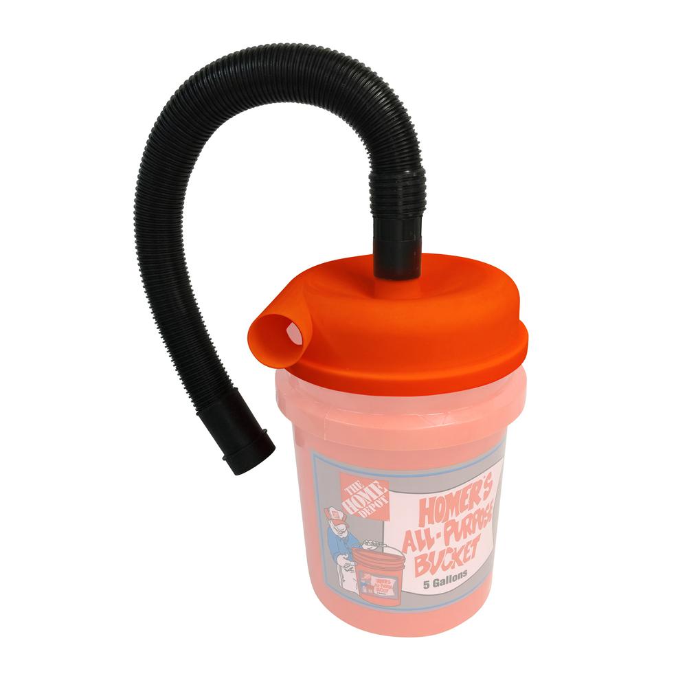

Take a look at the Duststopper being sold by Home Depot. It works very well.

Funny that I haven't heard about the Duststopper until now. It looks like it has a been out in the market for atleast a year.

I stumbled across it yesterday. With such a low profile, it seems it could be built into a shop vac relatively easy. I spent a while on Youtube looking at various configurations and cart people had built to combine them with shop vacs.
