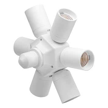

I'm using multi bulb fixtures, as well as some task lights. The fixtures hold 3-7 bulbs and they hold them parallel to the ceiling which seems to reduce the eye catching glare some leds seem to have.
