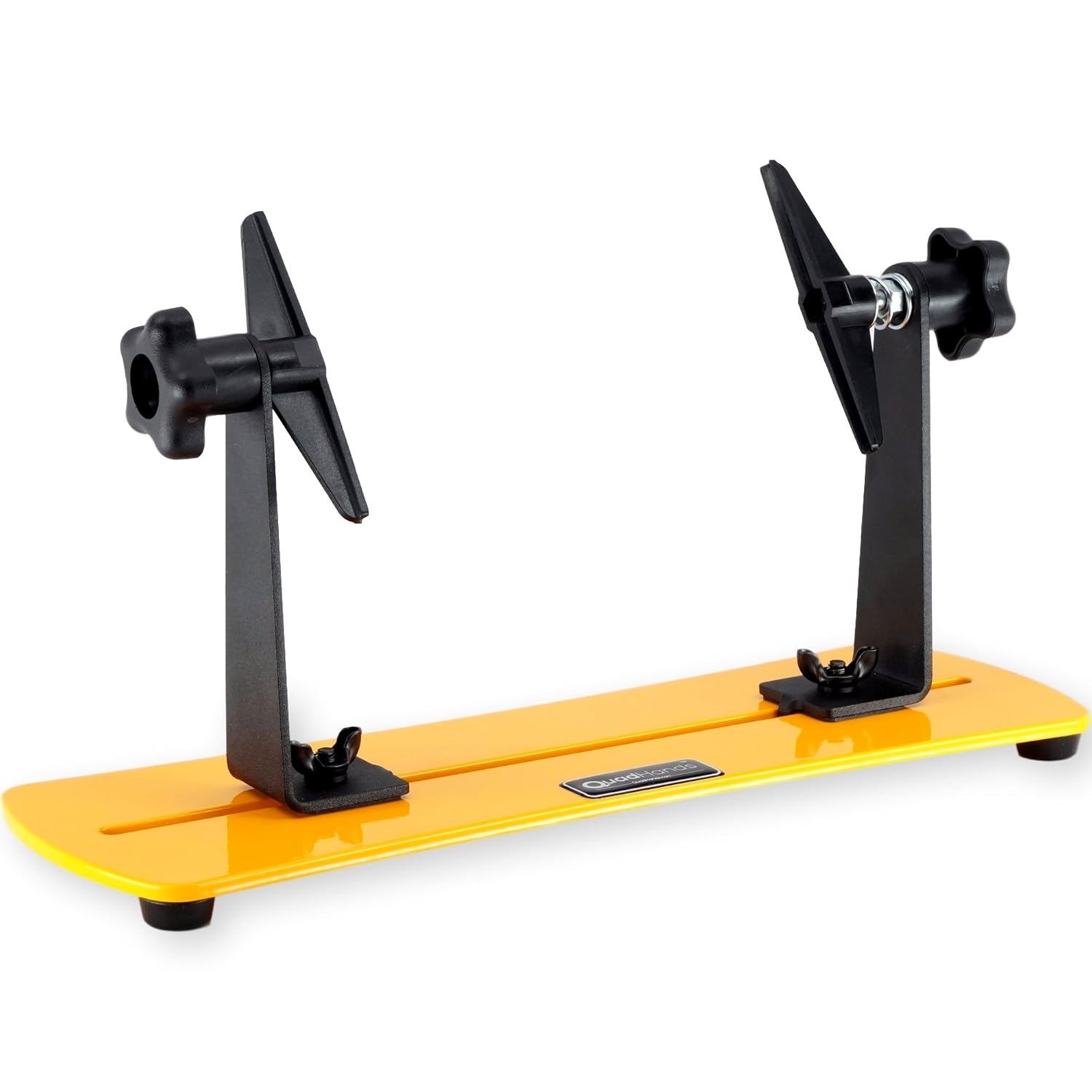

I'd fab something like this to go on top of a Fastcap Third Hand pole.

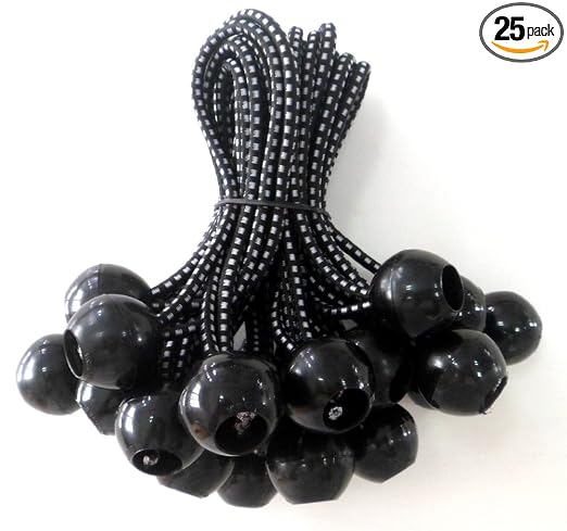

Instead of attaching the column to the vac with parts "C", "G" and "E" in your diagram, I'm thinking a short section of the extension tubing to shove into one of the accessory holders that are usually arrayed around the bottom of the can might hold it well enough. That would sure be a lot easier to remove when you need to empty the can or use it for other clean up tasks.
Another way to simplify the connection of the hose to the post could use one or two of these ball bungee cords with holes or screw hooks in the top of the arm:
