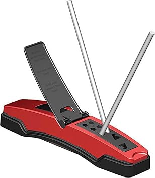

I like the Gatco, and the Lansky seems to be the same, now that Gatco has dropped it. These have the perfect grit transition, and you will get a good razor ede, even if slightly less than what the Spyderco does. A strop would take care of that if it is important, in use it isn't.

These still show up, or you can just buy the new version. They all seem to have two grits, and two sharpening angles.
Another one like the Gatco:
https://www.amazon.com/Idahone-V-Type-Ceramic-Sharpener-rods/dp/B004JJV66U/ref=pd_sbs_200_4?_encoding=UTF8&pd_rd_i=B004JJV66U&pd_rd_r=F4T5030W3JZGNT90PXT8&pd_rd_w=sO5xq&pd_rd_wg=sepxF&psc=1&refRID=F4T5030W3JZGNT90PXT8

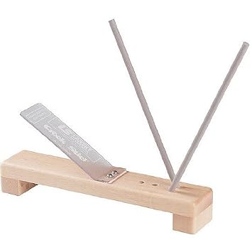

Lansky
Hi Terry
The grinder that Tom shows excels at shaping the blade. However, if you wish to add a "perfect" bevel to the blade - not just sharp but also well shaped ... fine and even - then you need a jig that makes this process repeatable. The Lansky does this very well ...
