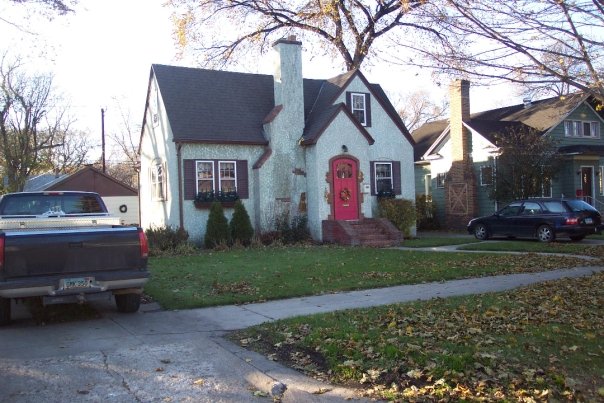

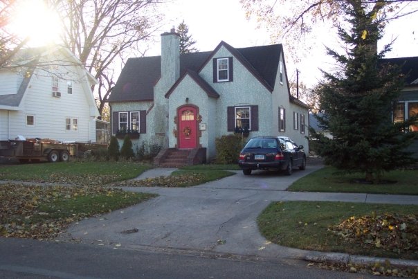

I gave some thought to that statement and realized that is what draws me to Art Deco lines-I have lived with it.. I grew up in Grand Forks, North Dakota- I lived in this house till I was 13 years old-
It was built @ 1932 and while it's overall form is maybe more Cape Cod in look- the arched doorway, front stairs and chimney have those AD lines.
The inside has even more AD details including those curved plaster transitions from the vertical walls to the ceiling.

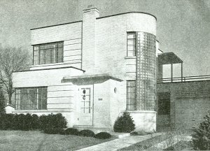

A couple of blocks away from us was a house that resembled this Art Deco design.
As kids we thought it was a space aged house where the "Jetsons" lived Ha! The house was lost in the big 1997 flood but this picture is very close to what we saw growing up

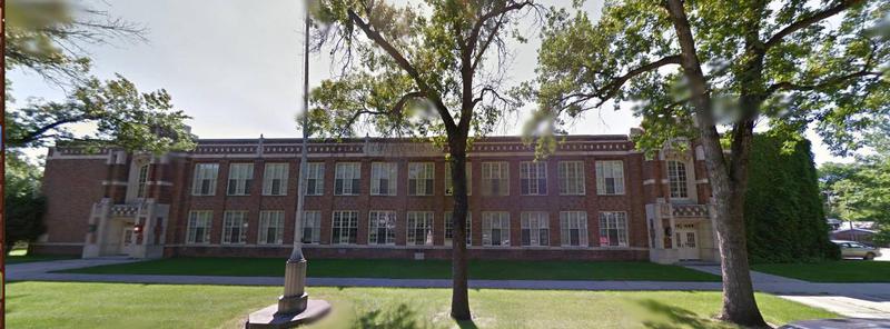

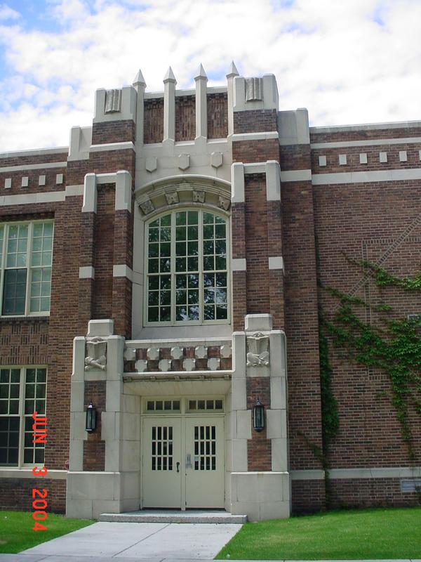

A block away from the stucco house we grew up in was the Junior HS I attended-
Now a Senior Living center it was "South Junior High School for most of it's life.

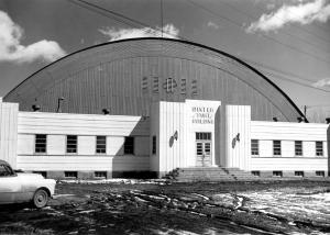

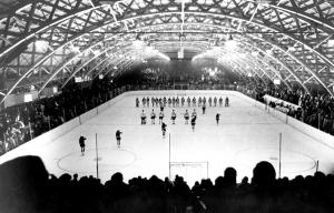

Another Art Deco Structure in town when I was growing up was the UND "Winter Sports Center" where the University's Hockey team played-
A glorified Quonset that was terribly cold, it never the less was a magical place for a young lad.

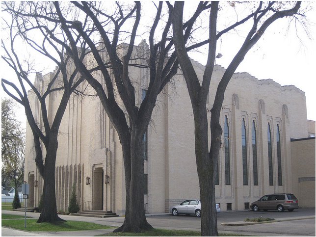

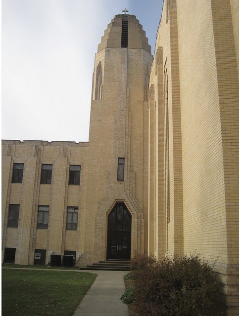

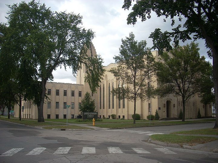

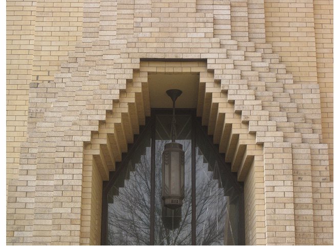

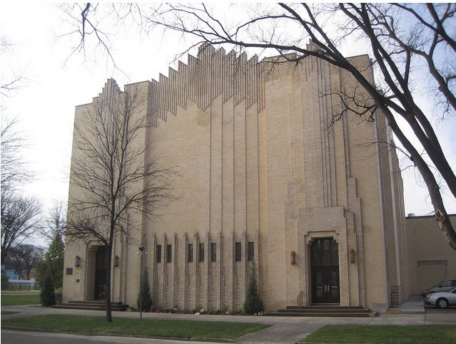

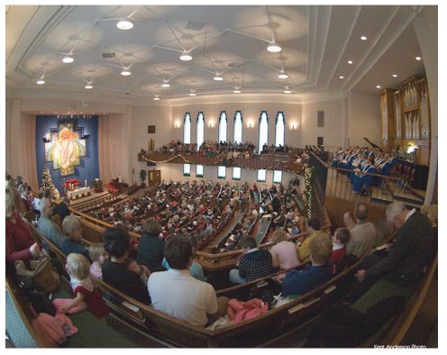

By far the most influential Art Deco structure I encountered growing up was United Lutheran Church- A wonderful architectural Art Deco Specimen-
Notice this outer face- It's design is reflective of a large Pipe Organ- That organ is just behind this wall on the inside-

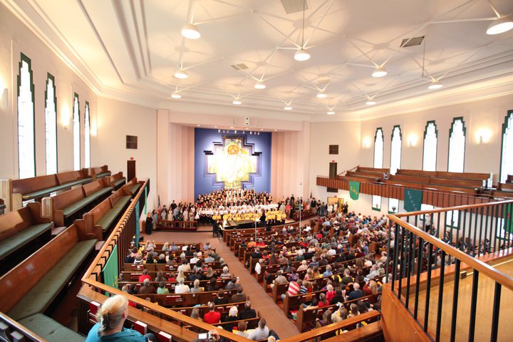

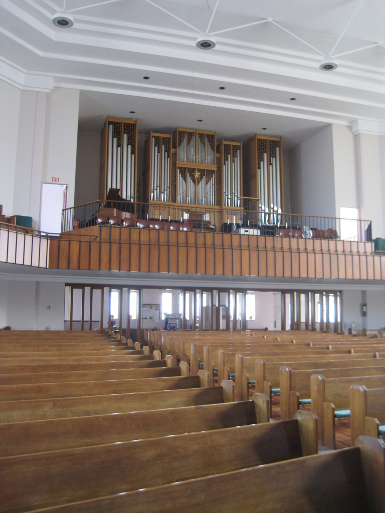

Here on the inside of that wall is the Choir loft and large Pipe Organ
I was always enamored with this beautiful sanctuary. Even the ceilings has a great Art Deco tiered or layered transition.
I still have dreams every now and then where I am hanging from those lights!
