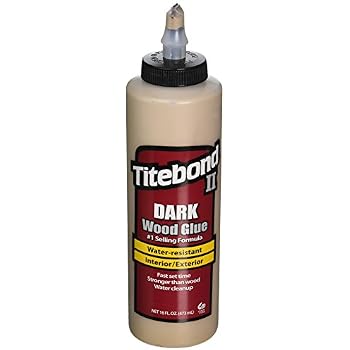

What glue did you use?

I used Unibond 1 for the veneering
I used Titebond II Dark Glue for the Solid wood-to
-plywood glue up...
