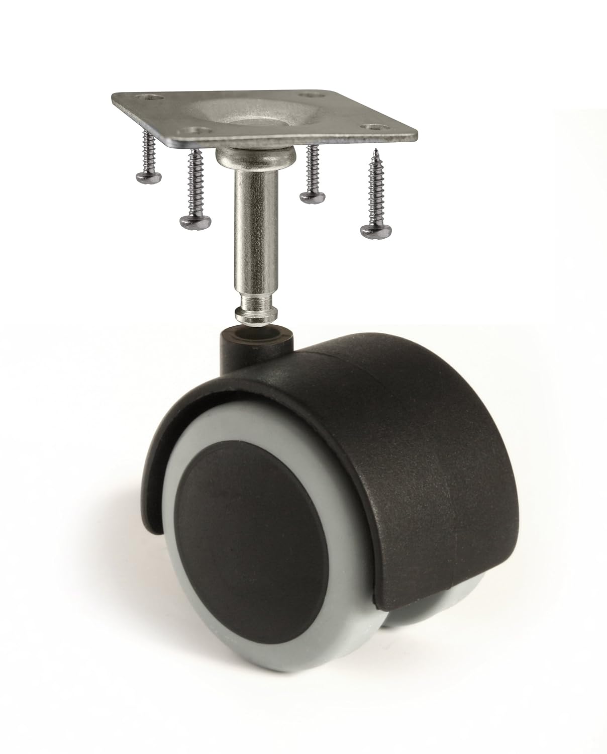

Friend wants storage drawers rolling on floor to keep shoes under her bed. Caster wheels likely require too much height. Think in I remember seeing larger individual larger ball bearings in screw on frames but haven't been able to find on Internet. Does anyone have another approach or familiar with ball bearing in screw on frame? Thanks in advance.

You don't need to attach the casters to the bottom of the box. You can build cantalevered enclosures for the casters inset into the corners of the box. Casters like this have a very low profile, are light weight and quiet:

The bearing casters are what I was remembering from plans for tablesaw and planer roller stands. Two of the boxes would have to be slid in under the bed and then left or right behind nightstands. Recessed casters would be an elegant solution but too complex for her budget and my patience.

There are several problems with bearing casters: They are relatively high friction, they are noisy, and they will test the Janka hardness of your floor boards.

Woodcraft sells "corner casters" that are partially hidden if the four sides of the drawer extend below the bottom, but still would have a net height of 2 1/4" to the bottom of the drawer bottom. The lowest overall height I found is at McMaster Carr and still has an overall height of 2". They are $28.40 each, and the Woodcraft corner casters $16.75 for a set of 4. Of course, no comparison of
quality and performance under load, but how heavy can a drawer of shoes be?
I have given further thought to William's suggestion to cut out the corners of the drawer bottom and mount the casters higher. I don't think it would add so very much additional time after all, but not sure how much surface area would be lost on the drawer bottom.
Think I'll ask her to find a stack of books totalling 3" (corner caster + 1/2" plywood drawer bottom + 1/4" fudge factor) and see if she can fit every shoe, upright or on its side, between the book and bed frame.
